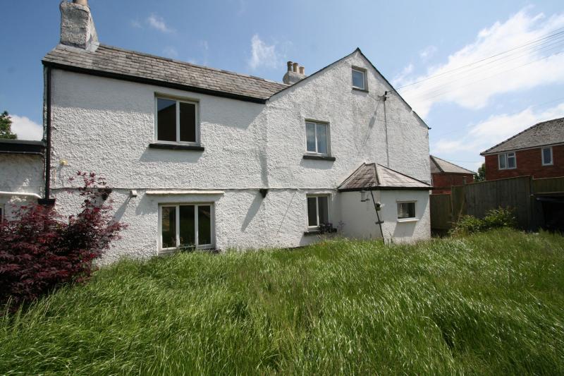

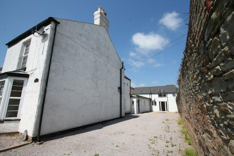

Did you look at the pictures Aussie? It's a detached house and annex. The inside and outsides need completely stripping and re-rendering and plastering :eek:
What sort of house is it and when was it built?
This is it:
It's detached, approx 100 years old. It comes with an annex at the back.
And here is the state of the inside due to the wrong render...
Not sure about "wrong " render - has it been coated with one of those "Lasts a lifetime" sprayed on plastic coatings :mad: . The windows are naff too :cry: Basically you`ve got a 100 year old mass of damp brickwork hidden by a skin of c-rap : When it`s all removed in and out ( you then have to insulate to a modern standard because you`ve removed so much plaster AFAIK ) and address any other wood related problems caused by the damp - Me personally , I wouldn`t want it if it was an inheritance :cry: BUT if you look around the web you`ll find lots of info on Heritage Buildings and breathing render etc. Good Luck anyways. ;)
Cheers Nige. It's actually sandstone. I did ask whether it was a sand and cement render as I read that lime should be used on sandstone. It's also cracked everywhere so all indications are pointing to the render being to blame, but they still haven't replied to my email with my 3 dozen or so questions! Yeah, windows are double glazing, not my fave style :unsure:
