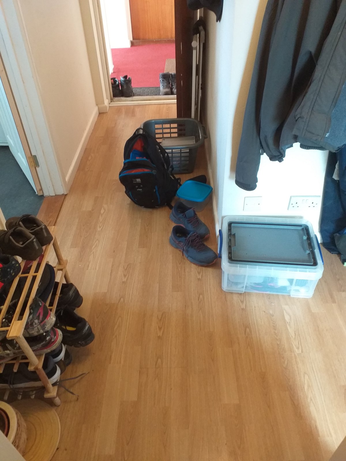

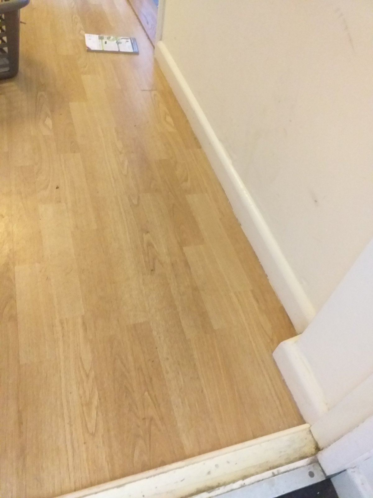

Looking at my current laminate and colour of door thresholds, should I go for a certain colour for new laminate ? I might just practice first over the top of old stuff (and I've never done it by
myself before) and if it goes well do the lot?
If I rip up the old laminate, can I easily put it back?
The guy in the flat below me moved out because of all the noise. One issue was walking on the laminate. Can I get a really thick underlay?

Looking at what you have, it looks like it’s been laid and then the skirting had been fitted. You’ll have to remove the skirting to get it up.
So just lever it off then glue back on?
I spoke about good underlay and was told gold underlay reduces the sound by 20 db . Hopefully the flat will be better off
It may be screwed on. You’ll just have to do whatever it needs to get it off. They’ll probably be a bit of making good to the wall paper when it goes back on, especially if the overall thickness of your new boards and underlay are less than the original.
I'll try and prise it off gently and get the same thickness of laminate. If not, I'll have to re-paint the walls I guess
