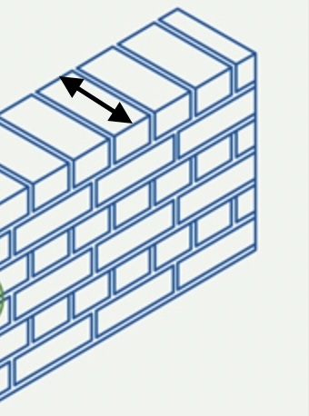

I'll be using threaded rod to ensure a strong fixing but I just stated some templating today and noticed immediately the wall (from front to back i.e. the depth of it) is not level. It slopes significantly backwards.
I don't want to fix the balustrade tilting! Any suggestions to easily rectify this without rebuilding the top course of the wall?

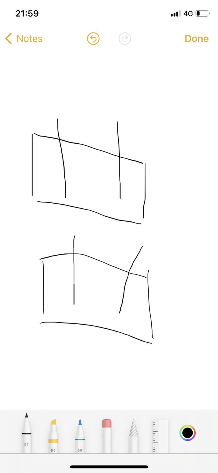

one thing I haven’t worked out is if I would be better drilling the rod at an angle to match the other rods. Or to drill normally. Any thoughts?
Rubbish drawing but hopefully makes the point.

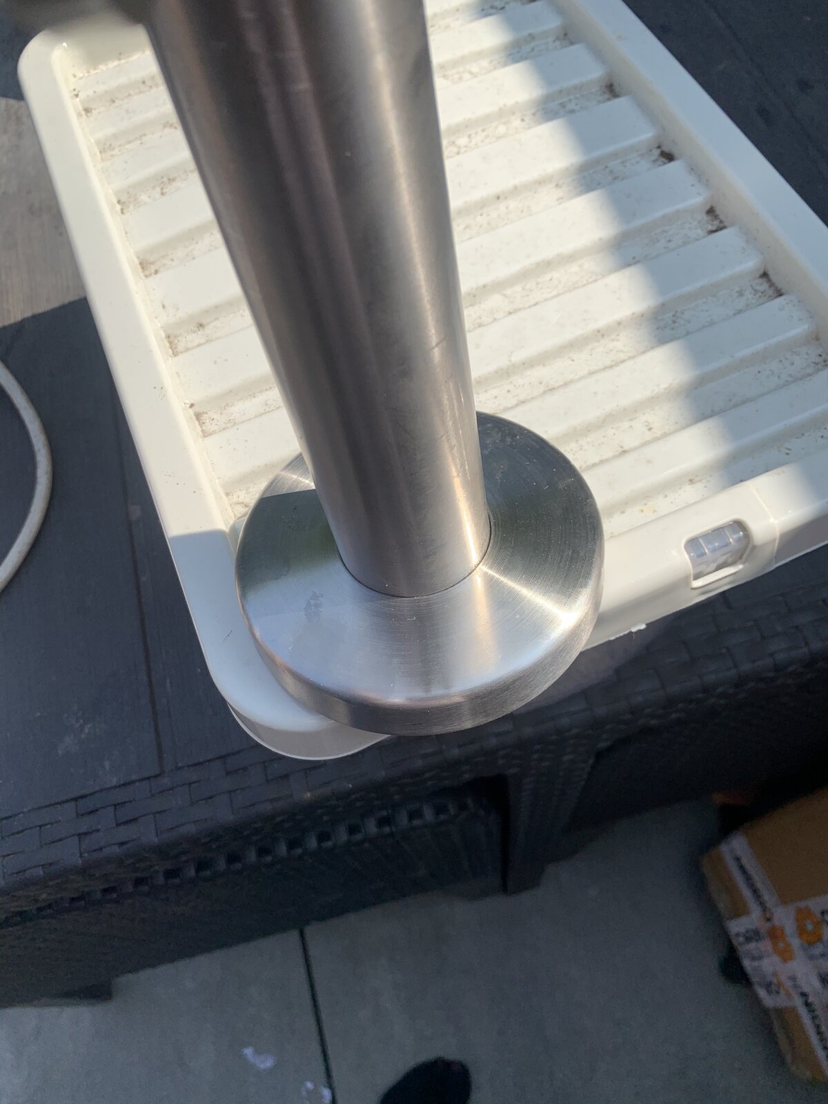

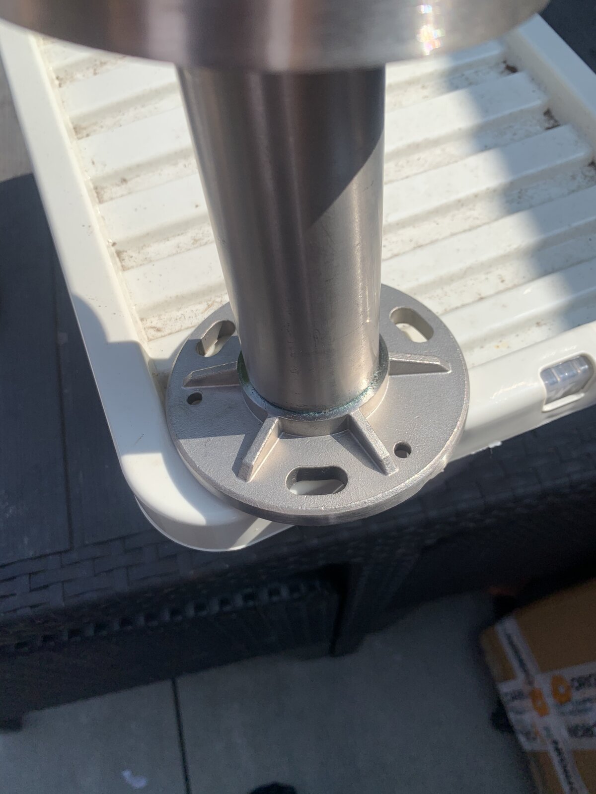

Can you post a pic or a link to the balustrade you have got?
If I can see how it is arranged it might give me some alternative ideas. (The plastic shims would be fine so long as not overtightened).
Thank you. See attached.
You will need to drill the bar vertical otherwise you will be defeating the purpose.
Those covers look ideal but they may not sit quite flat on the brickwork. It will depend how much of an angle the run out is.
Have you considered a small hardwood block with the base angled to give a horizontal base? The wood can be protected with preservative before fixing to help prevent rot. You may even be able to get a local carpenter to cut you some if you make a template of the size and shape. A circular block, fractionally smaller than the post cover, would be ideal.
