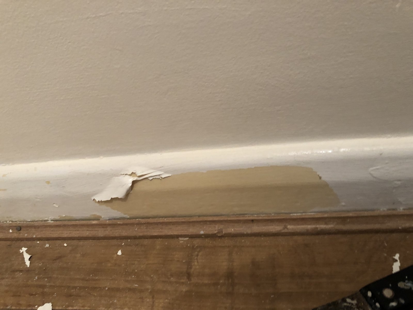

hi chaps just got a new house and wanted to give the skirtings a lick of paint.
Before I do I thought I’d scrape any flaky bits off.
But big layers are coming off.
Seems like the yellow bit was oil based paint as it has a sheen. Peeling paint is water based paint?
What shall I do? Peel off what I can then apply the water based paint I have bought? I don’t want to apply oil based as in my experience it always turns yellow. I’d rather it stay white and use the water based paint
But just want some advise on the flaking/peeling issue please
This is the paint I intend to use

Probably applied by a previous person who didnt key the surface with glasspaper....
Remove what you can, but if its a real bore then a coat of Zinsser primer will help seal the surface.

Thanks - I scraped off what I could and applied the water gloss I bought seems to be sticking
Will apply zinsser in problem areas as I have some left from a bathroom ceiling where it was flaking too

I groan whenever I encounter waterbased finishes that haven't been keyed. I invariably end up having to scrape all of the paint off so that I can then sand the previous paint flat.

OB will discolour as a result of a lack of UV light.
2K paints and shellac based paints won't yellow and although far more durable than WB paints, they are more difficult to apply and the catalyst used in 2K paints is isocyanide which requires appropriate breathing equipment.

You MUST sand down all gloss paintwork, no matter how good condition it seems, before applying new paint.
All the loose paint needs removing, even the stuff that doesn't easily come off could really do with removing, in case it becomes loose later on.
Then rub down all the old gloss which was under the loose paint.
You risk the new paint peeling off if you don't rub down the old gloss.
New paint, particularly water-based, will not stick to old oil-based gloss.
Water-based paint, when fully cured after a few days, can often peel when applied over old oil-based gloss.
Oh damn. I’ve only just read this and applied water based paint to the old oil based paint.
There’s actually layers and layers of it I don’t think I was ever going to get it all off to be fair.
I hope it sticks now as I’ve finished the room all skirting boards and architrave. It seems ok. Touch wood it stays.
