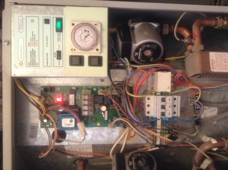

What are the symptoms??

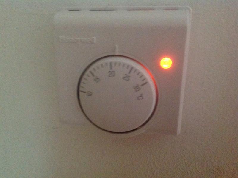

Thanks, we'll it started when my partner noticed the heating was off, checked thermostat, which had no light showing, checked the Boiler no power at all, checked the boiler upstairs, it was switched off. Turned it on, checked thermostat, that seemed ok as light was showing but the boiler still had no power, switched it off from mains and back on again still nothing.
Symptoms - no light on the boiler, opened it up and confirmed the PCB board is receiving electricity, the fuse seems ok too. Form here I don't now what to check or do? Called in a plumber and he took 1 look at the boiler and said it is the PCB, and would cost me 300 to replace.

I can see antagonism on both sides of the debate here, but as a DIYer, I would point out that it's not a good idea to try repairing your boiler if you don't know the basics of how it works.
I do not know this boiler, or why it is notorious either, but a quick internet search reveals it is a premix boiler. Boilers of this type have to be set up properly with the right equipment in order to be safe - they can be finicky things.
If you are intent on changing the PCB yourself, please educate yourself with what you need to know before you start the job. 'Pressing and guessing' won't be a good idea, could result in an unsafe situation, and could end up costing you more than professional help.
I would recommend that you get someone in if at all possible.

Thanks, I will not being changing it myself, I will be getting in a plumber, in ever intended to Do it myself, but I don't feel comfortable when the guy comes in and tells me it's the PCB, just by looking at it, I have found the price for the PCB - £180 new or £70 for reconditioned, both have 12 month guarantee.
Should I avoid using the reconditioned PCB

I'll leave advice about whether to buy a reconditioned PCB to the experts, as my competence runs out in that area.
However, what I would say is if you buy a reconditioned PCB, most of it will be old, with a few new parts. If you buy a new PCB, all of it will be new. In my experience of electronics, if one part fails, another is often waiting in the wings...
