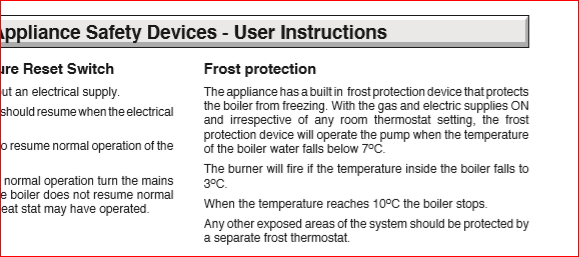

I would guess the frost protection is kicking in, not sure on your model but most boilers use the main ntc as the frost sensor so if it drifts out of calibration the boiler thinks its colder than it really is and brings heating on.

According to the manual its got frost protection built in... ?
do you know the gc number of your boiler?
Oh Ok... Found that bit in the manual after seeing your picture, The manual shows G.C. No. 47-047-24. Should I be testing the Thermistor CH Flow and Thermistor CH Return? In the wiring/parts diagram I can' see anything that specifically refers to the frost protection device.
