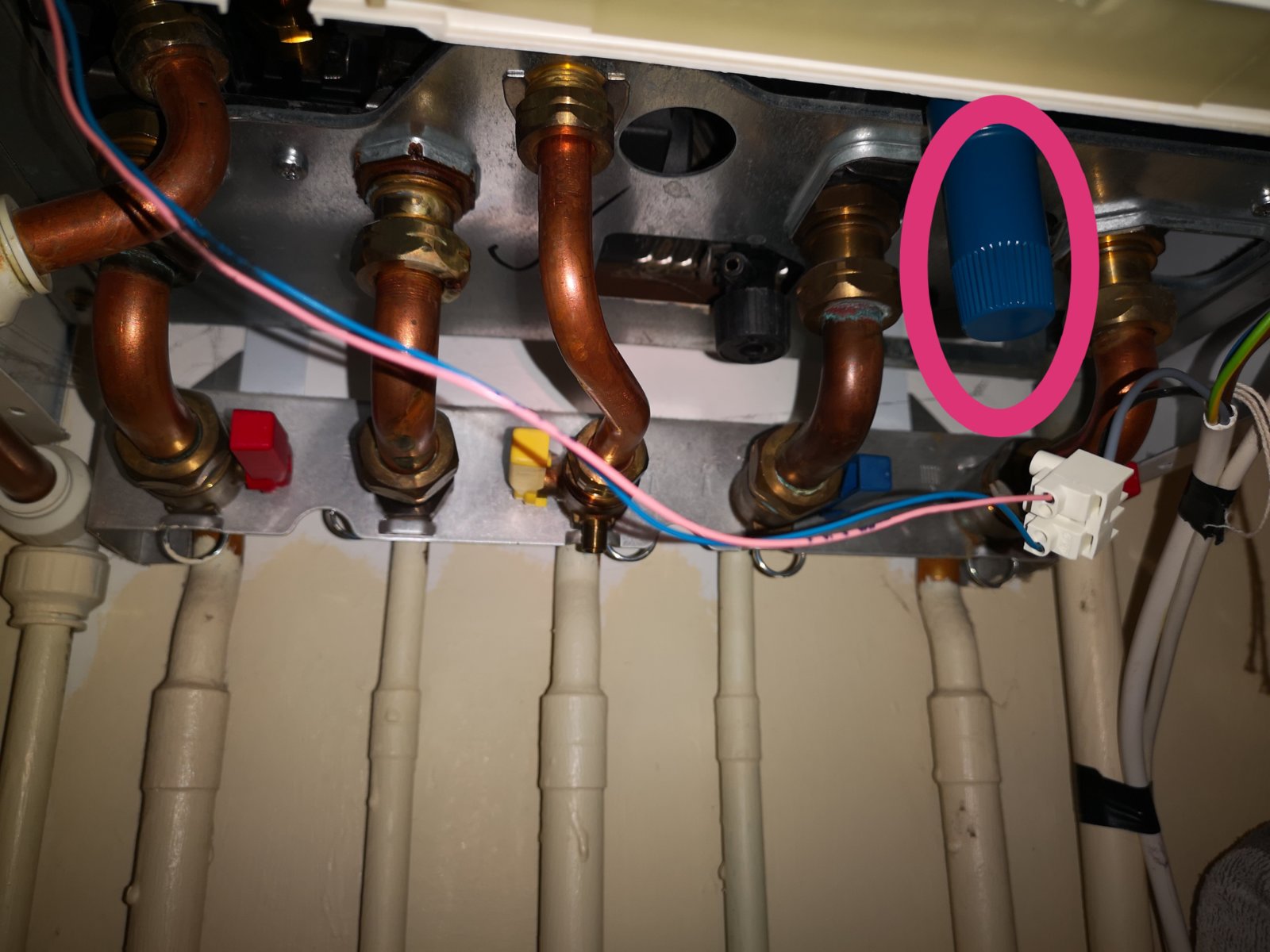

Hi,
When running a bath this evening, the hot water went cold and when going to the boiler it was flashing red.
So when opening the pressure valve, water came out of another area of the boiler (see video) and did not make any difference to the situation.
Please let me know if there is anything I can do to resolve this, or if I will need to call an engineer?
Many thanks

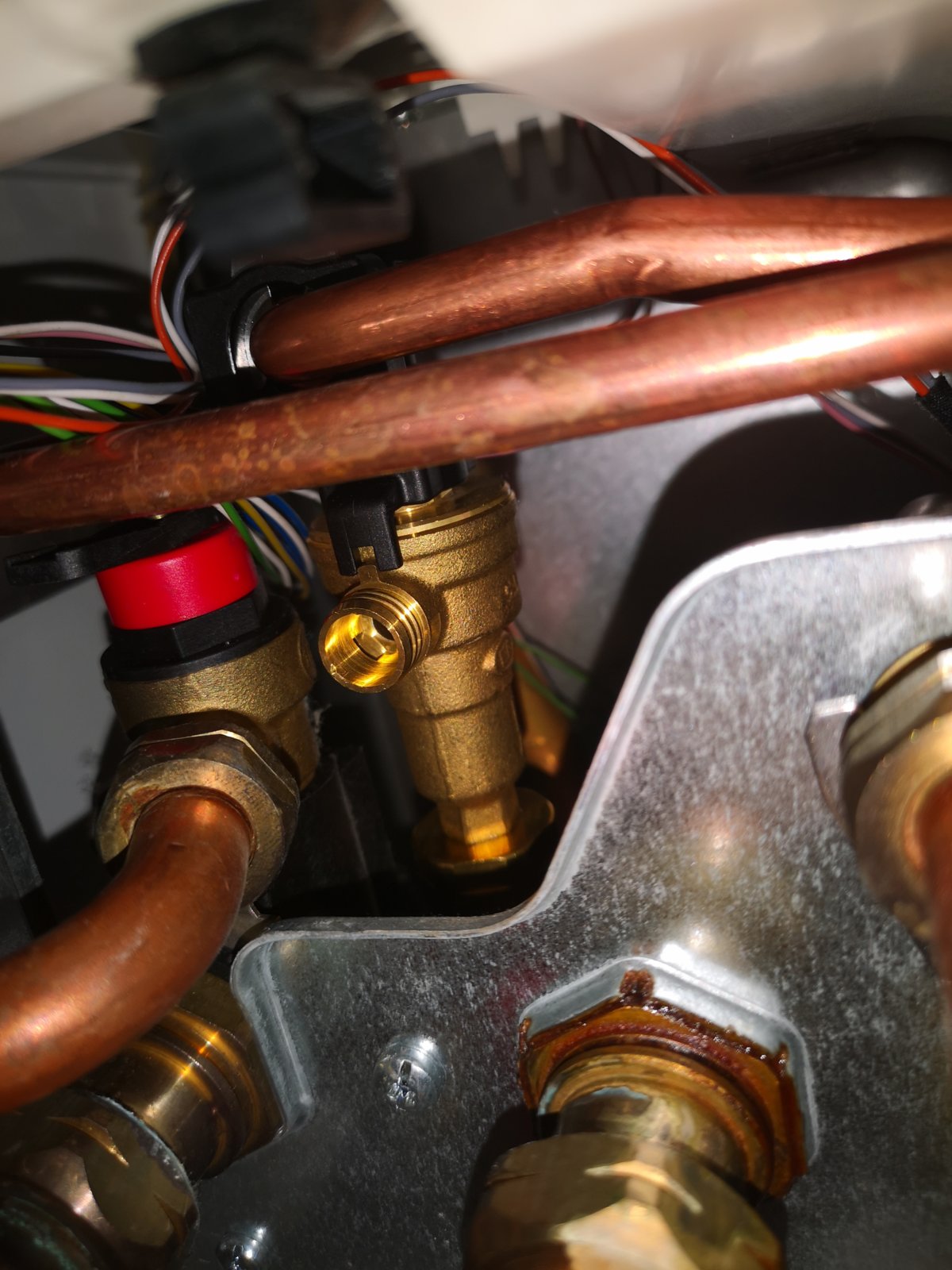

It won't allow me to post it, it basically runs out like tap water
post a pic of where the water is coming out , it will allow you to do that

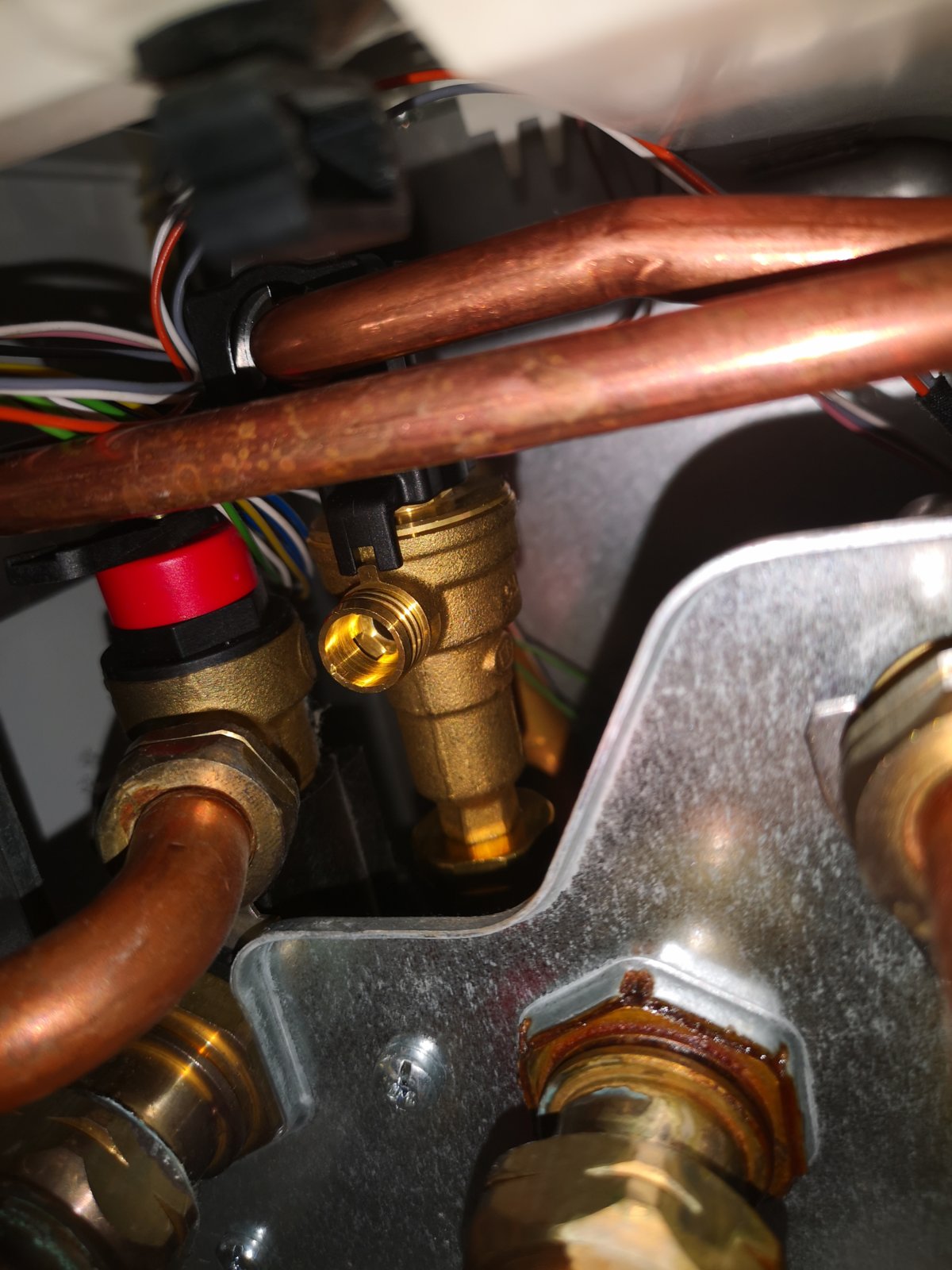

Image attached shows where it comes out
What do you mean by " when opening the pressure valve" ?
Can you post pics of what valve you refer to ?
Your pressuring the boiler over its maximum limit , you have a few issues going on , get an rgi In
The valve that's leaking is a rpz, basically a fancy non return valve that allowed glowworm to sidestep the water regs, it needs to be changed.

Also, about 2 months ago my husband had to bleed the air in a upright radiator in the bathroom. There was a lot of trapped air, which was only heating halfway. So put the boiler pressure from 1.0 to 0.7.
If it's the rpz, how much would I be looking to resolve this?
The filling loop kit is around £70 so that plus labour which is variable.

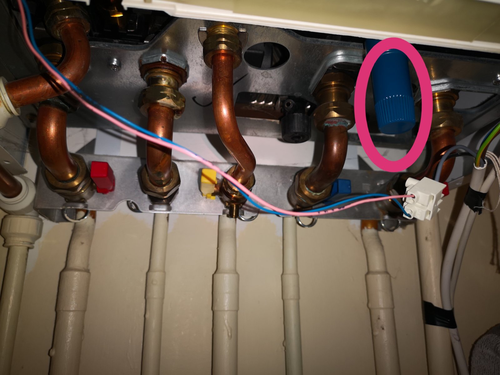

Please see the attached file to show what I am opening to try and raise the pressure in my boiler.
Put a new filling loop on and charge vessel wolesley part no 440442 it's called a disconnector
