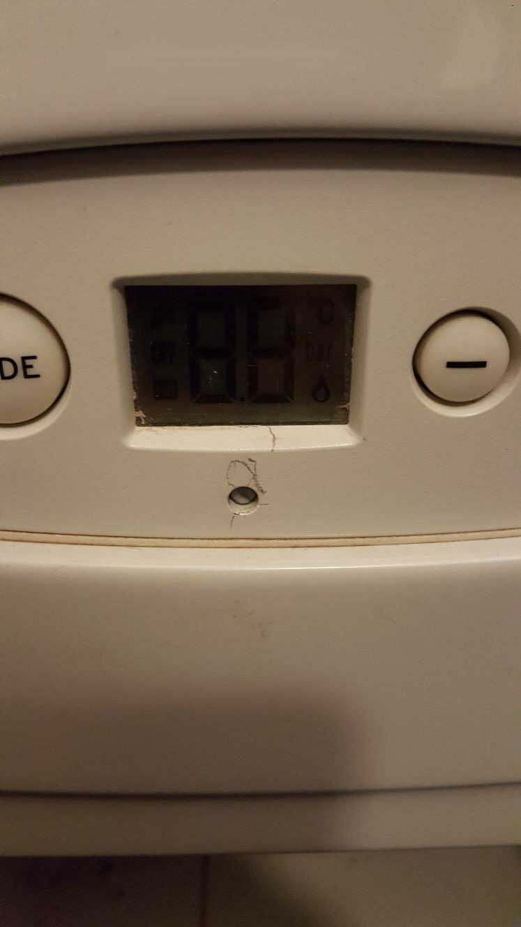

Hi,
Can anyone tell me if they have had a flexicom with the display locked on all characters?
It is preventing display of pressure, being able to put in hi/low flame etc
I am going to try and source the display (hoping it is a separate part to PCB and easy to replace!!)
But would like to know if it’s anything else, like the PCB for example that could be efffeting the display?
Many thanks in advance for any advice
It wont be the display at fault, the main pcbs are known weak point on these.
Thanks for the reply
To be on safe side I am going to quote for both as needing to be changed. I know some may disagree but at least I will only be charging for the 1 visit.
Thanks again
