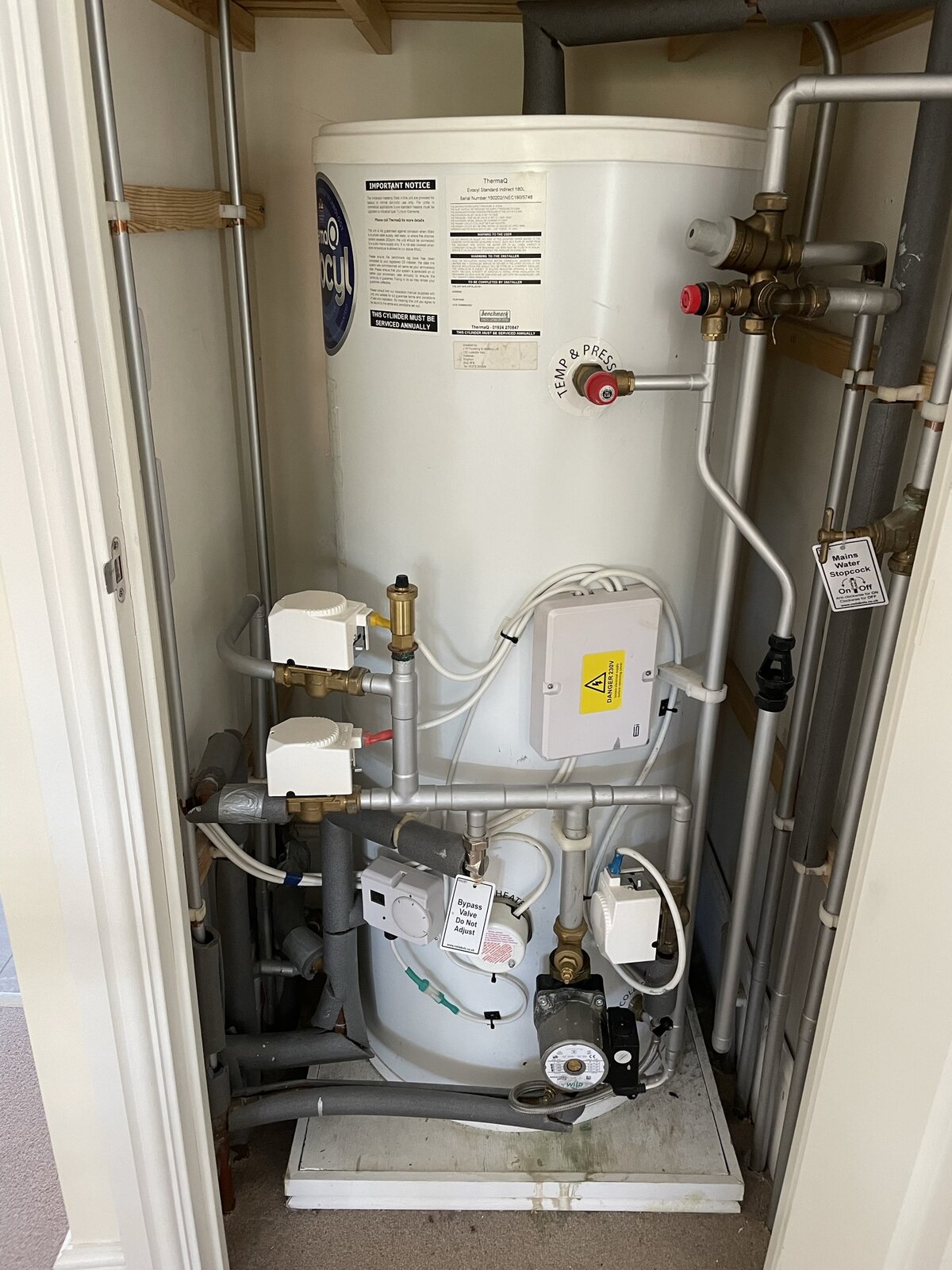

We have 2 heating circuits (house is 2015 build) split by floor, plus hot water tank in the upstairs cupboard along with the various pressure vessels, a wiring hub of some sort, and a couple of motorised valves for the heating circuits.

So the layout of the system is standard S config 3 valves:
(Please excuse the mess under the pump from when the pump seals failed!)

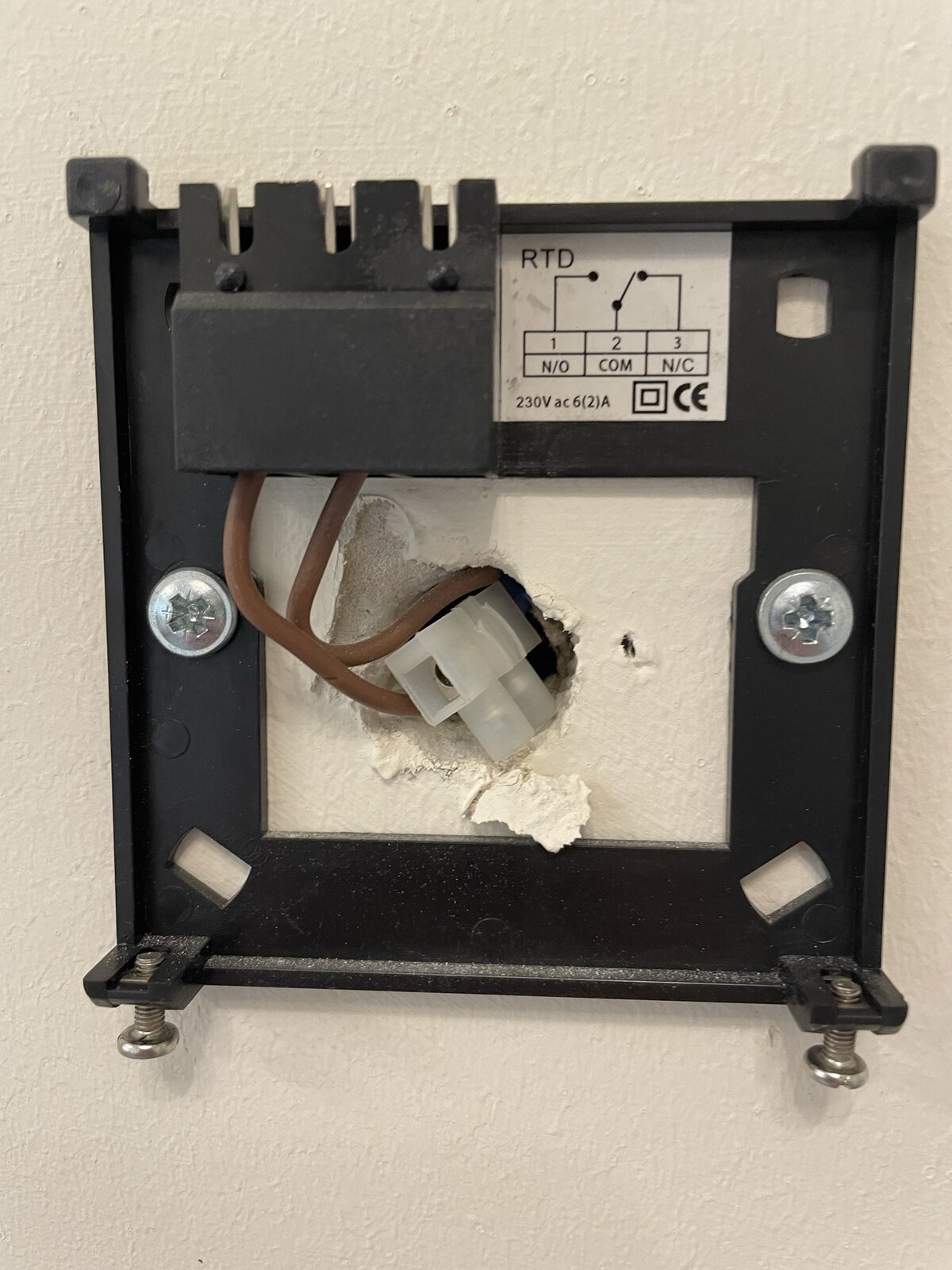

The 2 heating circuit room thermostats have connections to N/O and COM only (both have another wire terminated in a choc block, which I'm assuming is an earth)
One has x2 brown wires, the other has 1 brown and 1 black (same terminals used).

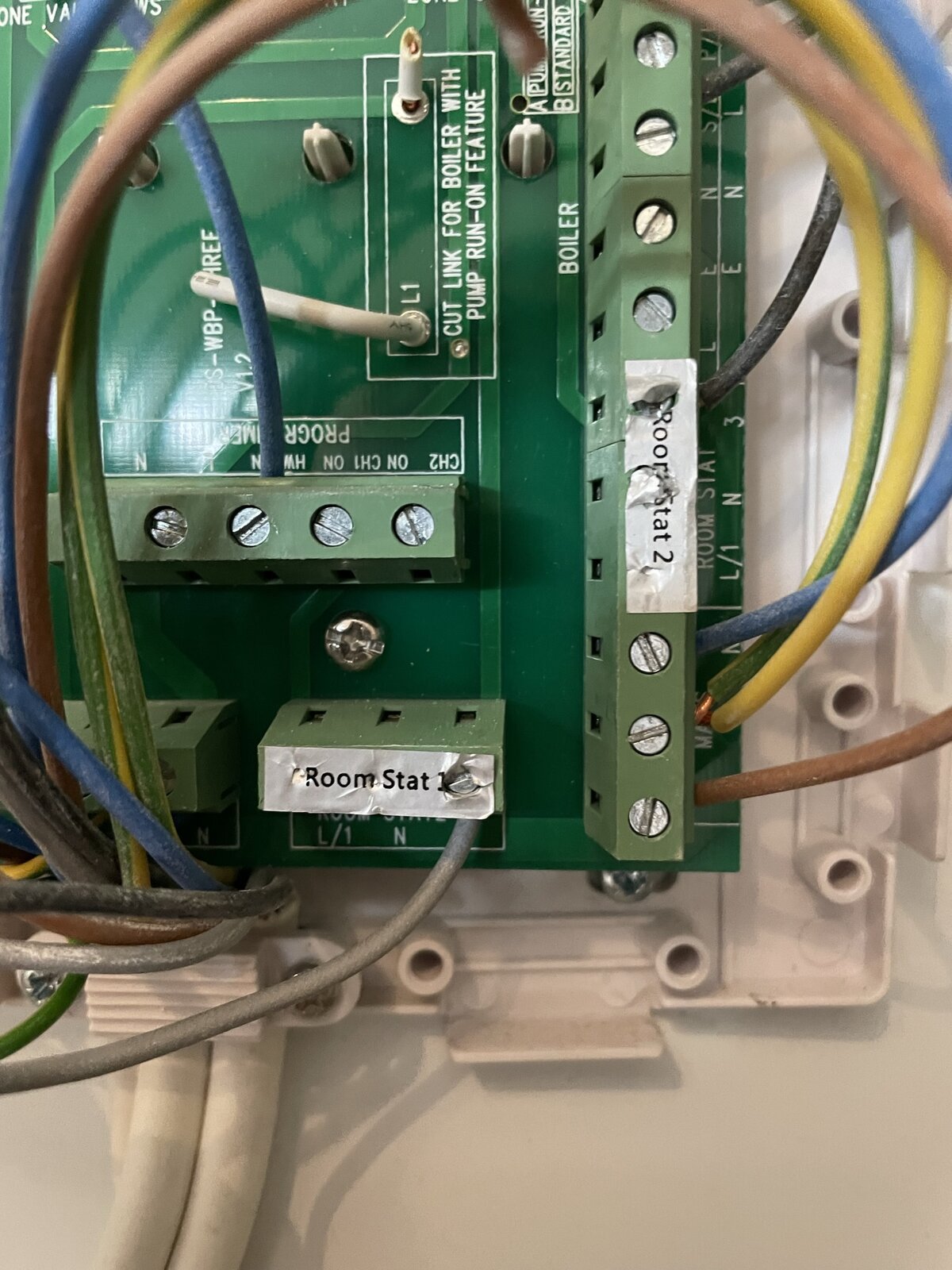

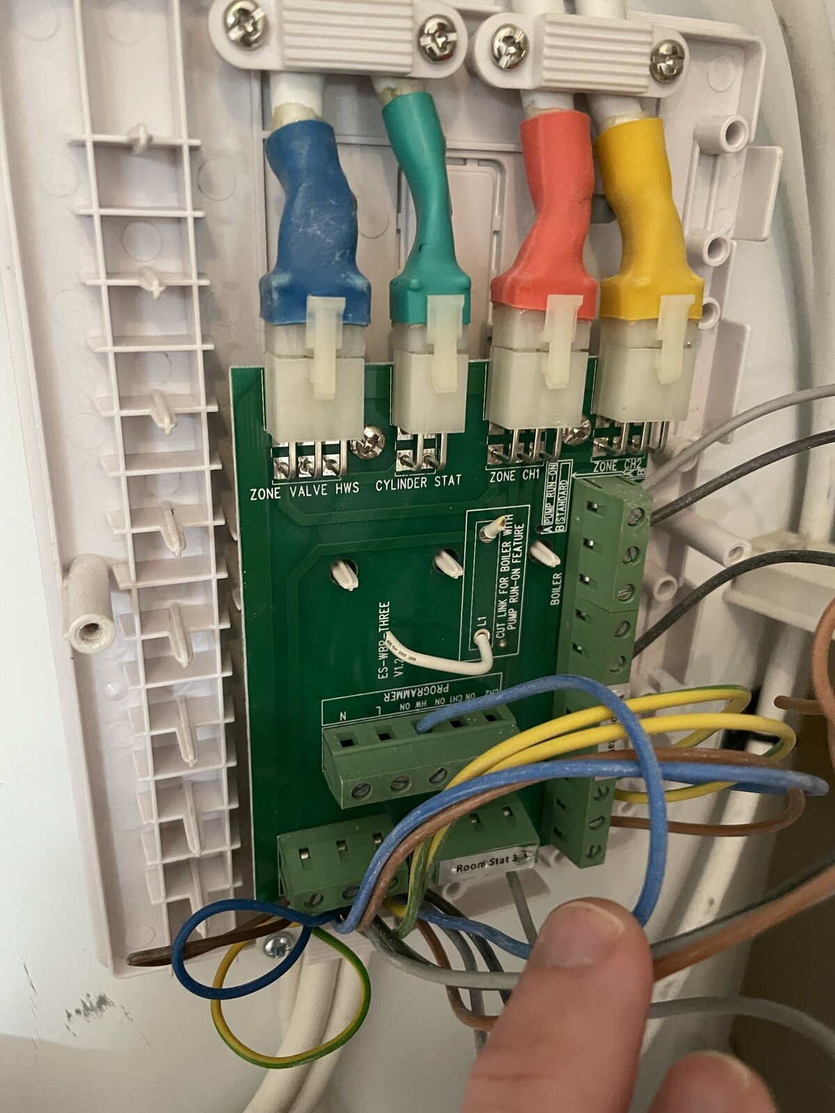

Rather than a 'traditional' wiring centre, the one we have is one of the ESI PCB ones:
So how does one go about removing the wired thermostats from the equation? I'd like to leave the wiring in place in case we move and want to put the old setup back in (plus it's all hidden behind plasterboard and will no doubt be a total pain in the arse to remove!) but unsure whether I simply need to disconnect the single wire attached to each of the 'room stat' headers and suitably insulate, or if I also then need to join the N/O and COM wires where the room thermostats are removed (noting the backplate says they're 230v), or if there's something more substantial required in terms of completing the circuits?

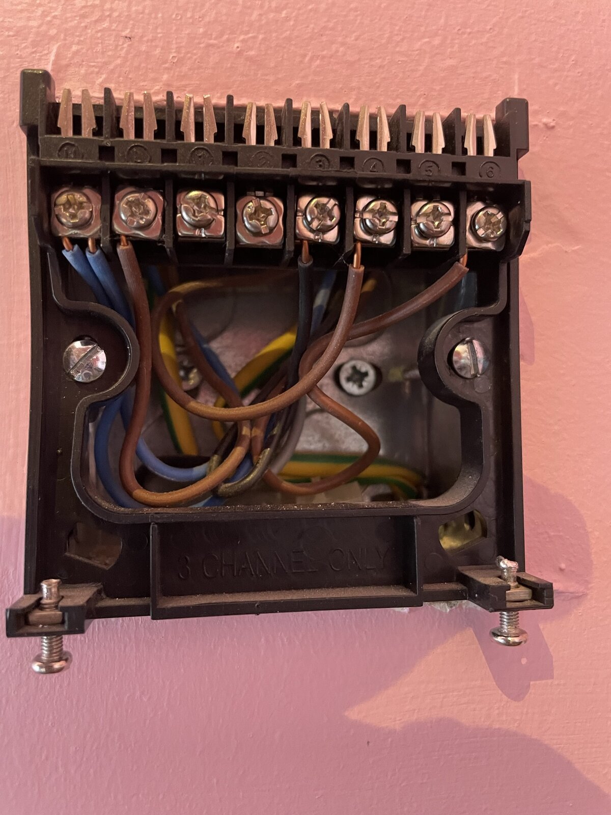

I've also had the programmer off the wall and the wiring to that looks to be a bit different to the Wiser (although not horrifically so). The ESI 3 channel programmer has connections to terminals 3 (HW on), 4 (CH1 on) and 6 (CH2 on) whereas Wiser suggests heating CH1 and CH2 go to terminals 1 and 3, and HW to terminal 2, so working on the basis those just need moving around to suit.
Programmer:
Existing connections:

The ESI controls backplate has more pins than the 'industry standard' so had to change the backplate. The wiring changes pictured above sorted out the move from ESI to Wiser, so just a case of reading what wire in the back of the ESI backplate needed to move to where on the Wiser.
My old wired room thermostats basically just had a signal loop back to the wiring centre, which doesn't meet ESI's installation requirements. I took a punt that joining the wires in the wall behind the old room thermostats would deal with those, which proved to be correct. I'm sure if I'd wanted to I could've done something at the wiring centre instead, but since I needed to make good the plasterboard anyway it seemed logical to make the changes there.
