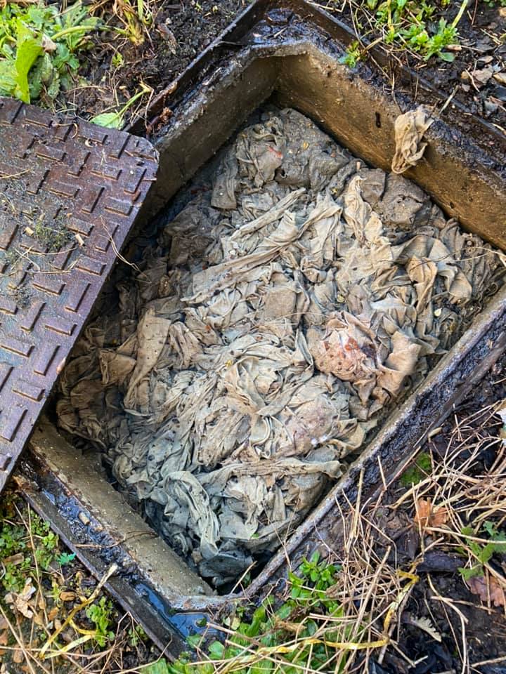

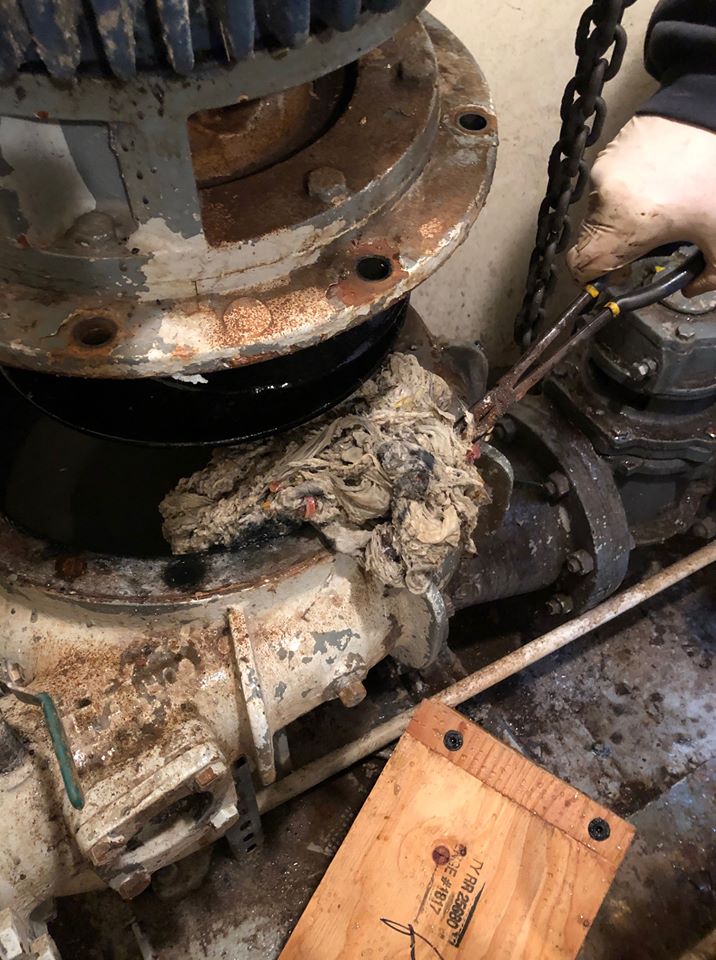

Mainly those with a jet washer as people block the drainage with kitchen roll and newspaper instead of using toilet paper
Its the wipes I suspect that are going to cause havoc, so many shops with the shelves cleared and/or limiting customers to numbers of packs that can be purchased. If half of them go down the toilet, then it's going to get busy I think.....
Agree with @Hugh Jaleak, wipes are a regular problem, given the panic buying, working from home and self isolation = more than a wipe/fatburg.
Two examples of what happens with wipes, blocked pump and chamber.... Chamber may only affect a few properties, I've seen pumps doing an entire village jammed up with wipes, and then the only solution to prevent a pollution is to tanker the incoming flow off site whilst someone has the task of stripping the pump down to unblock it.
