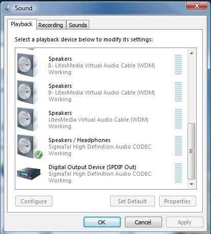

When I go into 'Sound' in Control Panel I get this:

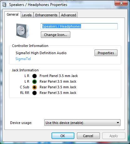

Again, as you can see the SigmaTel is ticked as the Default device and the Litex Media are all listed as Working. First question here is: Why are there so many Litex Media in that list? There are 9 numbered in total. Why is Sigma listed as 'Speakers/Headphones' and yet Litex is only listed as 'Speakers'? And what is that device at the bottom of the list 'Digital Output Device (SPDIF Out)'?
If I right click on the default Sigma and choose test there is sound coming from the 2 speakers. If however, I choose to use any of the Litex as the default and then right click and click test, no sound comes from the speakers.

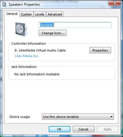

This is a screen shot of the Litex Properties:
I've chosen the one listed as number 8 as that is the one that both Camtasia and SnagIt both seem to default to. I don't know if it's important but I notice with this screen shot there is 'No Jack Information Available' where as with the SigmaTel next screen shot there is 'Jack Information':

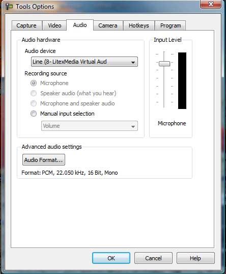

So now we move onto Camtasia Studio. In Camtasia Audio Options it defaults to 'Line (8-LiteMedia) as can be seen in this screen shot:
You will also note that the list below the devices is greyed out and 'Microphone' is ticked as the default. The only other one available to me is 'Manual Input Selection' and I've tried ticking that but still nothing!

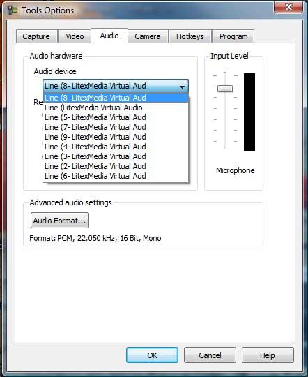

If I click on the Audio Devices drop down menu, only the Litex Media devices are shown, there is no SigmaTel. I have tried choosing each of the Litex devices in the list (1 to 9) but none of them give sound when recording!

There is an option in here:
In the Device drop down menu (as I've mentioned above), only the 'LitexMedia' is listed. There is no option for the Sigma. The lower options are greyed out and the only other thing available to me is the one at the bottom which is 'Manual Input Selection' but there's nothing in there but 'Volume' even when you click on the drop down menu.
