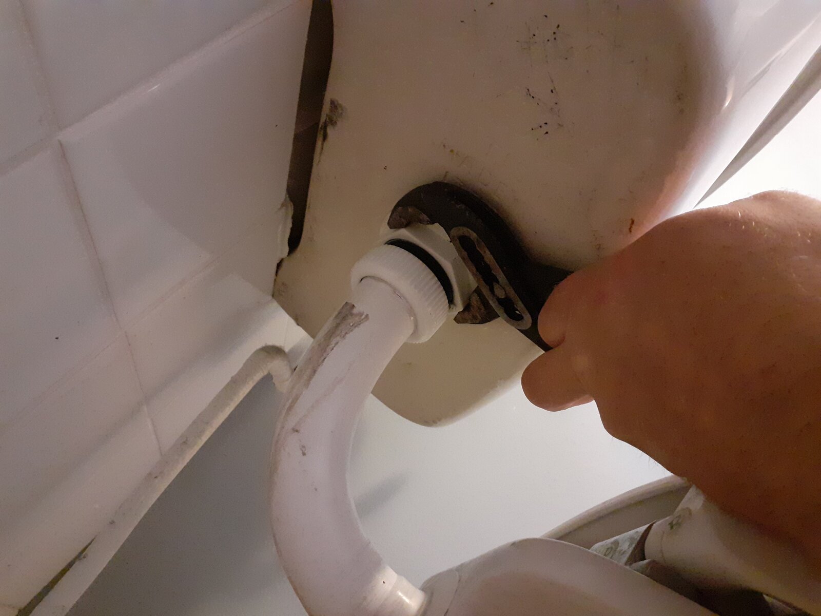

Did what you said and think t's the flush pipe. Apparently it's supposed to be pushed 2 inches inside the syphon. Having trouble now screwing the cap on at bottom of syphon. The rubber washer seems to be stopping me. It didn't before. Should it be flat side up?
Put a new flush pipe in (as in picture)but still leaking. I guess even if it says 5cm (in instructions) into the syphon I dont think the pipe is going in perfectly vertically. I then tried old flush pipe (which seems to go in more easily and vertically and goes in about five inches lol with new washer and cap and now it's not leaking from flush pipe.
Should the washer be pushed under syphon pipe and over flush pipe perfectly evenly for good seal? Line up syphon evenly on cistern hole (which is hard) for good seal too?
Also the positions of the ballcock and flush handle thing seems really crowded with new syphon Think they're knocking into each other unless really careful when tightening syphon from underneath. Do they look ok in picture?

Is the mating seat of the cistern clean, eg no silicone? Have you tightened the syphon backnut enough or too tight?

Where I tighten nut up underneath syphon there's no silicon but the rubber the other side on inside of cistern might have tiny amounts of hard water or residue under it

Only finger tightened shall I get a big spanner or grips on backnut for 1/4 turn? Maybe that will stop the odd drop I'm still getting?
Yes.

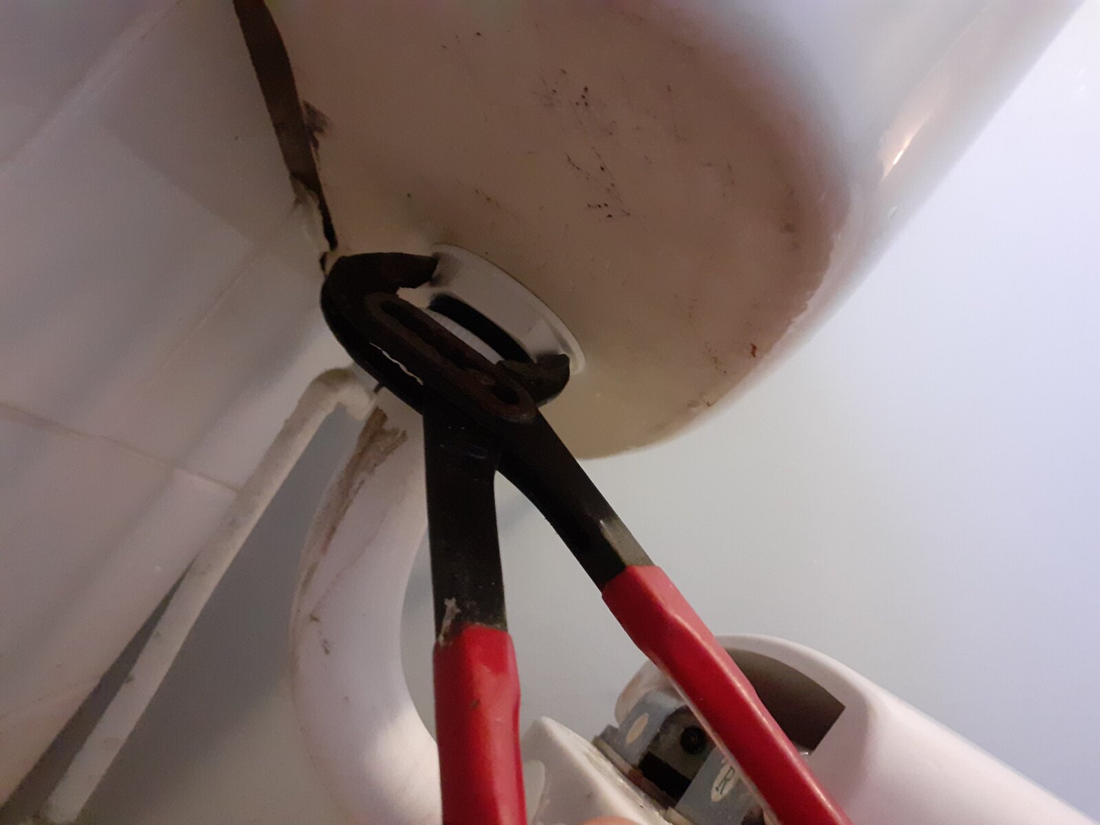

I tightened back nut with grips. Should I tighten coupling nut too with them?

Yes you can use it on the flush pipe nut to syphon, but again, just nip it up. Regards flush volume, it should be in the instructions, usually a piece of plastic.
Wrap ptfe around the flush pipe connection and clean the inside of the cistern where the syphon washer sits and make sure it's the correct orientation.
