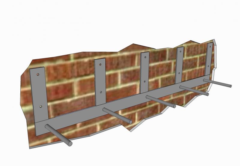

A client of mine wanted to do this, tbh I didn't pay too much attention as to whether he actually did it or what it turned out like as it wasn't within my remit to do, I just did it as a favour so I sketched a bracket for him to take to a steel fabricator to knock up. You would need to get the corresponding holes drilled into the depth of your shelf by a stone mason or similar and then resin the thing to the wall. Well you get the gist.
I guess you could cantilever it out of the wall though I would have looked for it sitting a full brick depth into the wall though that will compromise the depth a bit.
If you do go down the floating shelf route it will need more than just end and back edge support i.e. bracket as FMTs post.
Unsupported along it's length it will be very easy to fracture - as anybody who has fitted granite worktops!
Very good in compression but low shear strength

for the shelf I'm suggesting that the granite needs more than just support on three edges - as earlier post from FMT. I doubt that it will snap/sheer along the supported edges but that the centre/front unsupported section may fracture. It is unbelievably easy to crack a long/thin piece of granite.
The principle for most floating shelves is a concealed bracket supporting the shelf by steel rods concealed within the thickness of the shelf along it's length

Too much hassle, use brackets or maybe brick corbelling at each end.
Thanks for all the replies and advice. Have arranged for a local stonemason to polish up the piece and drill four holes for bolts
and resin fixing to the wall.
