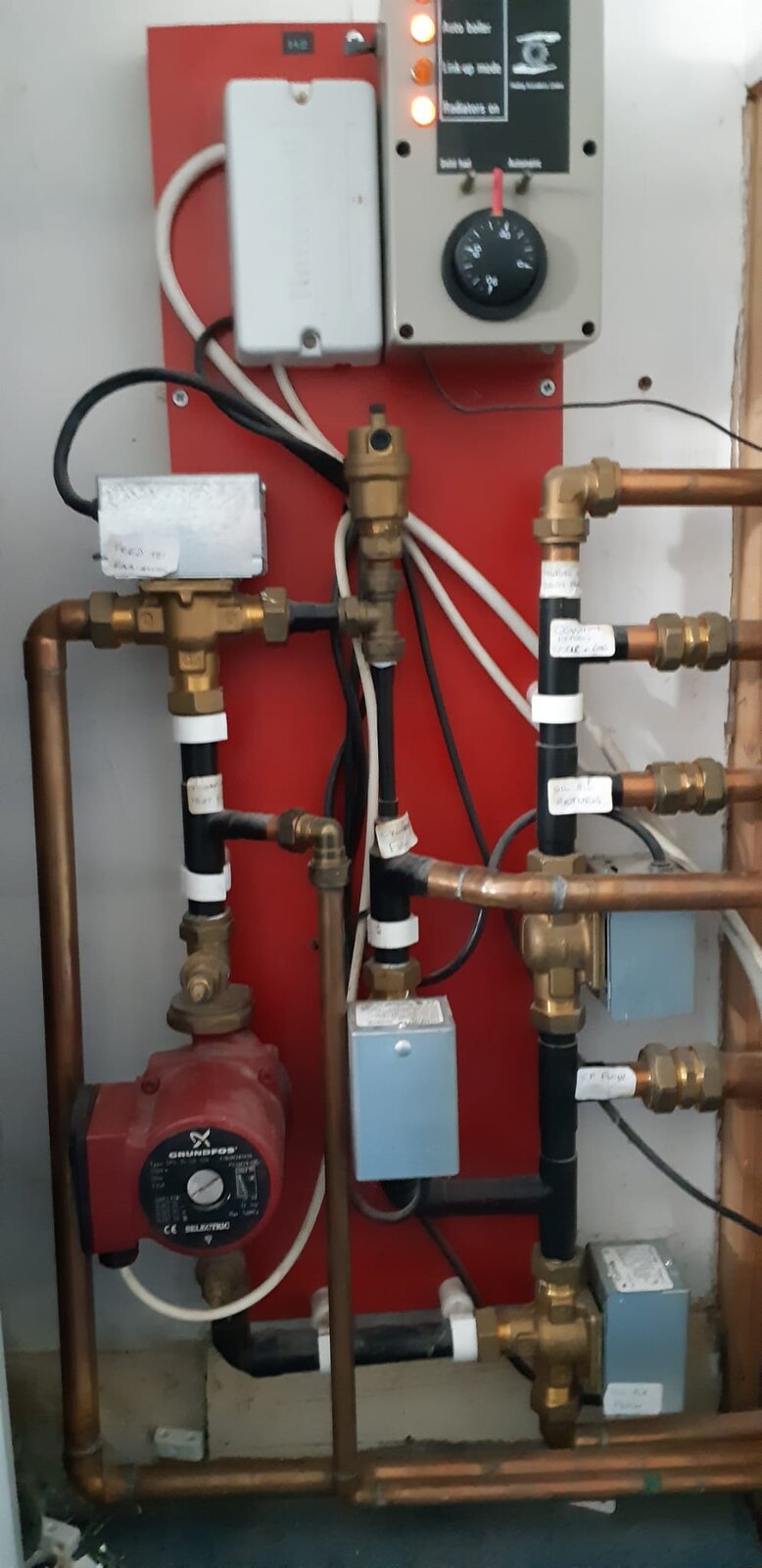

Rodders53, think the attached would be wiser than me trying to explain board for oil and solid fuel control.

Thats quite a complicated set up, I can't read the labels but can see that the top left motorized valve is a mid position valve, (MPV), there may be a problem with this in mid position, it may be hunting with both CH & HW requested, so suggest the following tests, with HW demand only and cylinder stat calling for heat (turn it up, if necessary) ensure boiler firing normally then request CH on as well, when both then calling does the boiler start hunting?, if so just turn down the cylinder stat (let it on at the programmer), see if the boiler then fires normally on CH only, if turn the cylinder stat back up and see if boiler starts hunting, if so, turn down the roomstat (let it on at the programmer), check that boiler returns to normal firing.
With both CH&HW selected and boiler hunting, listen closely to the MPV and see can you detect any noise.
If you can use a multimeter then a few readings at the boiler will tell a lot.

Just had a look at the MPV schematics and a very easy test that might work, select HW only on, switch off the CH at the programmer, there is a manual lever on the side/end of the MPV, keep pulling this across to its mid position until you latch it in (push the lever up), the boiler should/may keep running, see if its running normally now.
