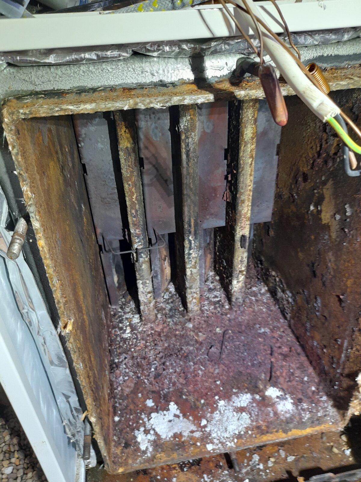

We are Grant registered installer's average around 2 a week very few problems
In the past 5 years have taken out 2 leaking Grant's both over 12 years old .
In same period taken out a leaking worcester nearly every week some not 4 years old.
Picture of 5 year old worcester found leaking 6 weeks out of warranty installed with worcester filter correctly serviced customer told where to go by worcester as its out of warranty !

That does not look good. I am veering towards the Grant

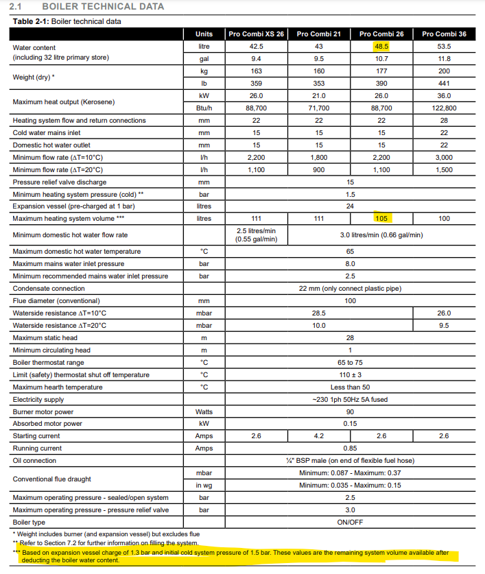

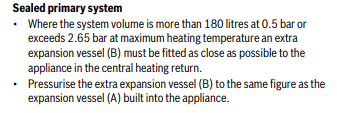

I am also looking at the EV as previous service engineers have said the 24L is too small for my house, which the Grant has but the WB is a 12L EV. WB manual says 180L at 0.5bar in the system, including water in the boiler. If I am reading it right, Grant says 105L in the system excl. the boiler, which I think is 48.5L. We have 13 rad and kitch/diner UFH. Included in the 13 are 3 large 2-column rads that total 45L alone.
I think I must be reading the manuals wrong.
I have been given bad advice from engineers in the past so I am trying to be as certain as possible

If your pushing anywhere near the capacity of built in expansion vessel I would be fitting a extra one.
Grant do make a 26kw combi that's narrower than the standard one expansion vessel is fitted elsewhere wherever you can fit it .
We have used that one with larger than standard expansion vessel to get round problem you have.
So with the 24L grant, it's still wouldn't be big enough?
We have certainly had to increase expansion vessel capacity on systems with several designer/column type radiators.
There is no pressure switch on current Grant combi's so we do tend to run them at .75 bar rather than 1 bar or above.
