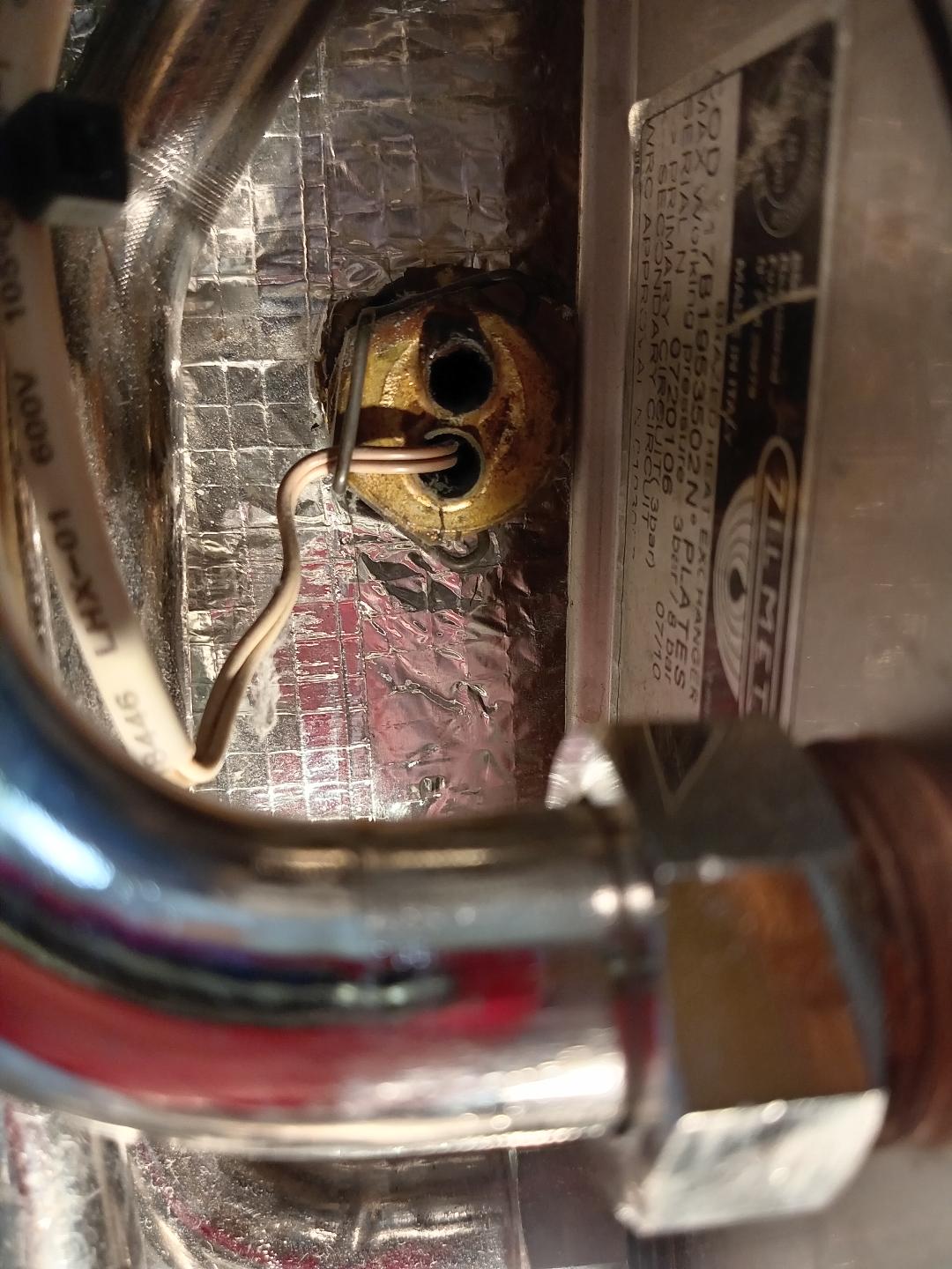

DHW LED flashing couple of times a second. Grant's docs suggest the ‘Store’ thermistor connection to PCB, or possible store thermistor. Any thoughts?
Teeny update. Checked connection at PCB and at store and it worked for a short time, so new thermistor ordered. However, where it sits seems full of muck, which I can probably clean with a cotton bud or similar. Is this normal? And I take it the circlip just holds the wire and nothing else!
We look after a good number of Grant combi's
First it's vanishing rare to have thermistor problems. In fact we don't bother changing when we change the board .
No not normal for pocket to be full of muck.
Not inadvertently got water on board have you?
Far and away the most common cause of failure.
Many thanks. I have a thermistor on its way so will try first. If it still messes I'll look at the board.
For the archive, the thermistor fixed the issue. If the DHW LED flashes once per second (rather than twice), it's the PCB, says Grant.
