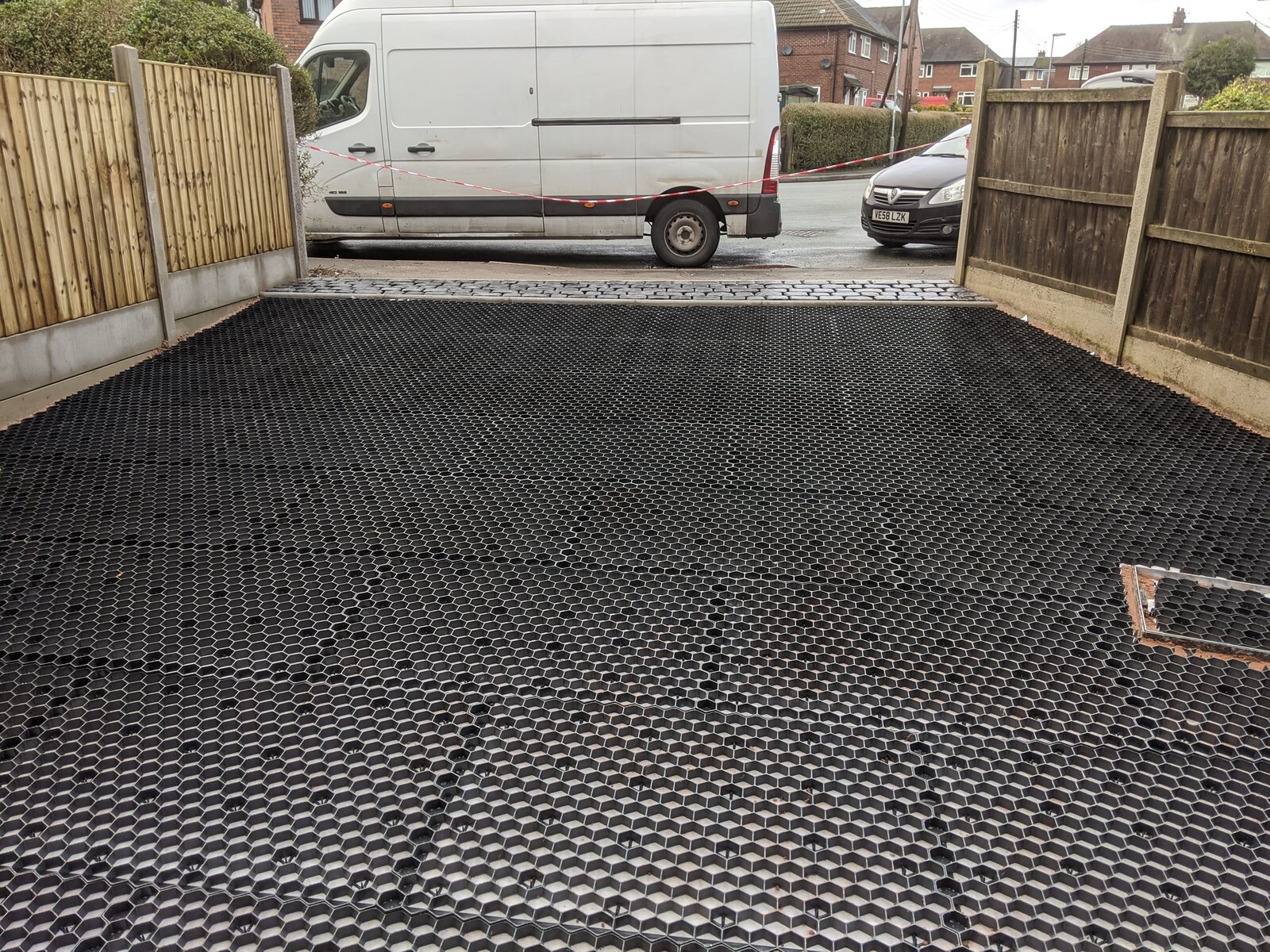

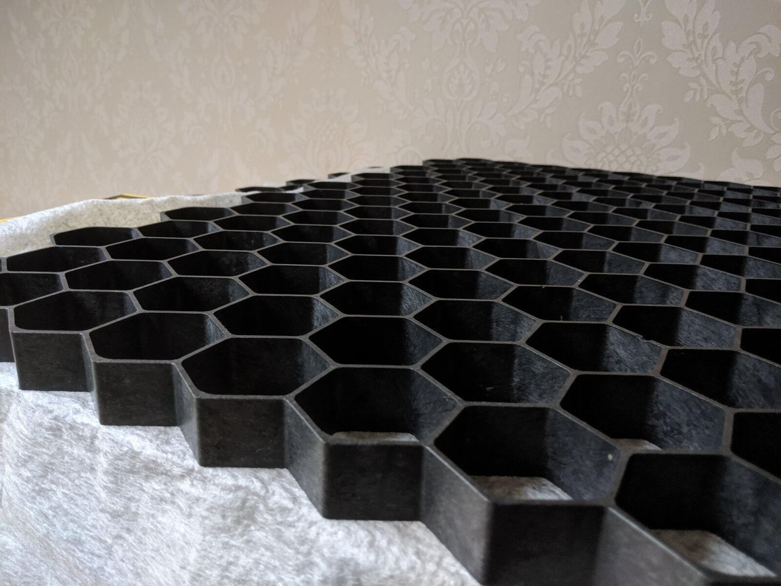

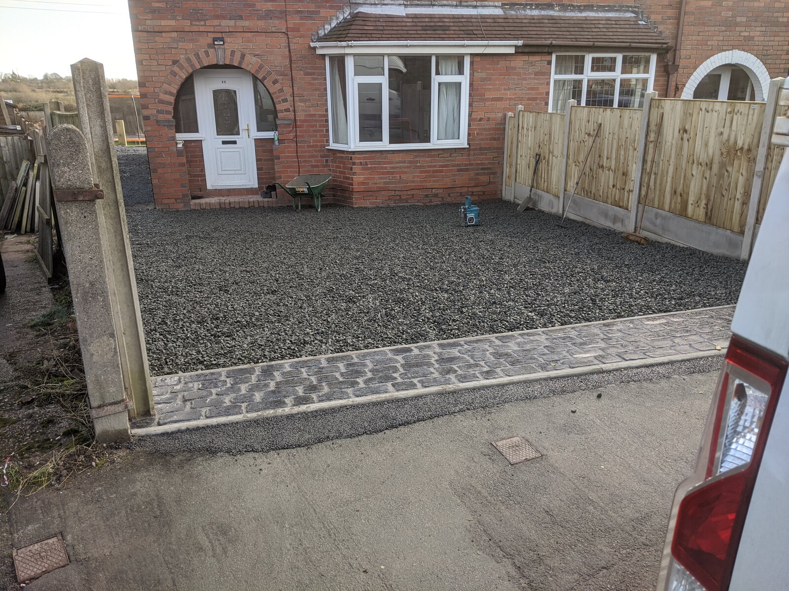

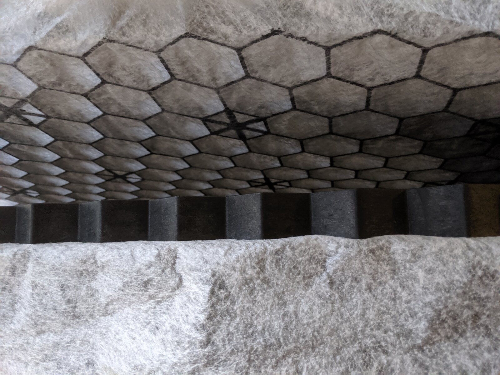

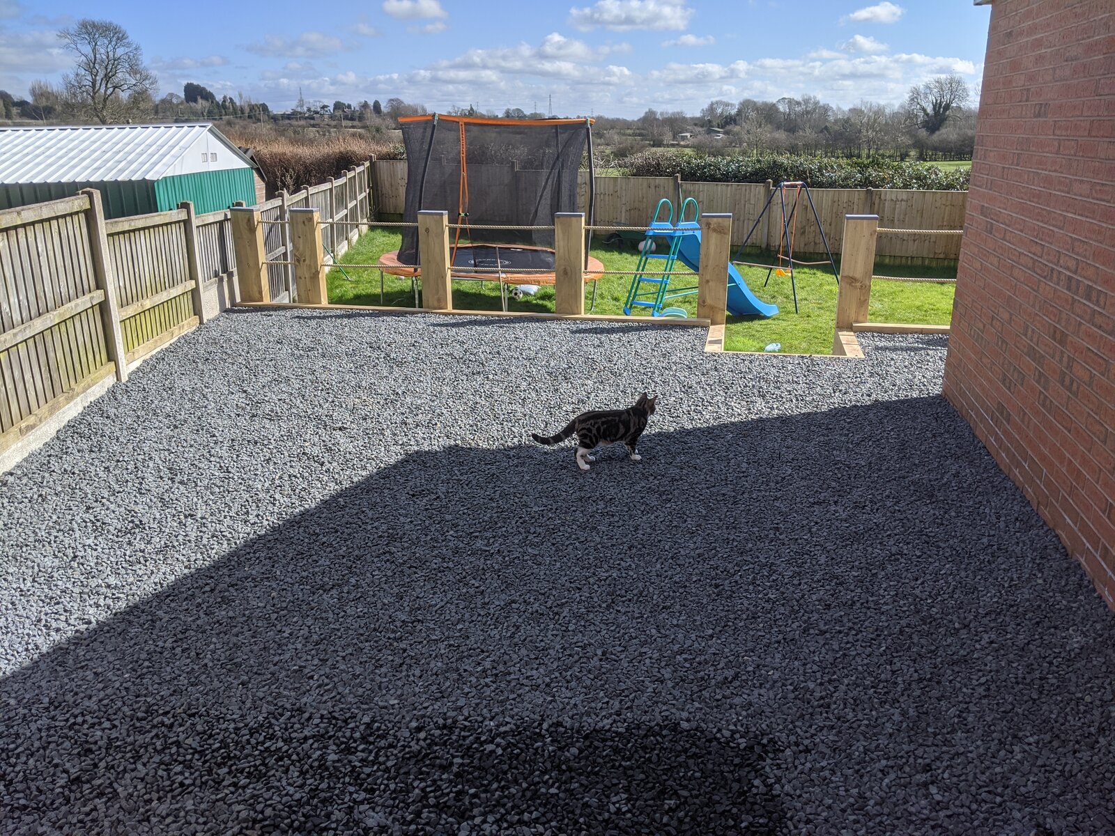

I was in a similar situation had a large area but couldn't stretch to tarmac, paving etc so used gravel but did it properly, grids, membrane etc it's been great.
You get the odd weed and leaves but once a week a have a quick whip around keep ontop.
Consider using 20mm gravel especially with cars and as mentioned the grids make such a difference if you can budget for em'. Uploaded a few pics of ours.

Looks well mate! I've decided against membrane as I'm not sure effective they are tbh. Hadn't considered the grids, did you get them from screwfix? My drive is massive and extra expense would be large :( Trust they are to hold the stone in place? Is that 20mm that you have used in the photos? Thanks
The grids I used came with built in membrane it worked out at roughly £8.50 per sqm which soon adds up but I can't stress the difference it makes.
Yeah the gravel I used is 20mm black basalt even this size we get a few pieces onto the road the smaller size would be worse regards cars. Angular gravel is also a better choice.

Maybe just consider the grids where you know you will be driving/parking. Unless you have 5 cars?
Great advice, Mike. Hadn’t considered that
Guys I'm figuring out how much grid to buy.. Am I right in thinking the most useful position for it would be where the car is likely to park or turn? Thanks.
I'd say that would be the most sensible. The gravel will want to migrate away from the wheel traffic areas so containing it there would be a good idea. You will run it bare though no matter what you do.
