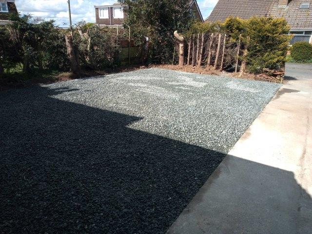

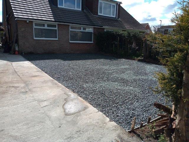

Hi all.. and thanks for everyone’s replies.. just to update this and for any reference
It ended up been 60sqm
dug out to 190mm
put in old fence panels for suttering off
Type 1 mot 19.5 tonne = 150mm
Nordic green granite 6 tonne = 50mm
Three loads in and out with grab truck
With respect to advice on putting gravel grids down.. to a degree this may depend on your budget.. but I opted not to use it
Im guessing I will have a small amount of maintenance to do every now and again re-rake it but Im hoping that will be about it. only time will tell
Attached are pics - it is completely level (just where it was drying out a bit after washing it over looks as though its not level)

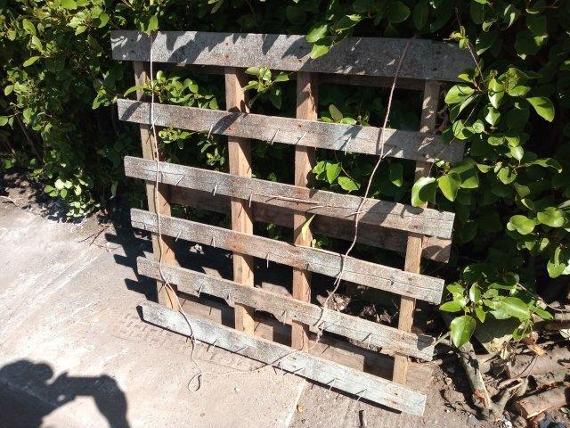

I found that to level either the type 1 or the stones - a wooden pallet with nails through it did a great job
Ill report back in a month or so and tell you if I had any problems
Thanks again
