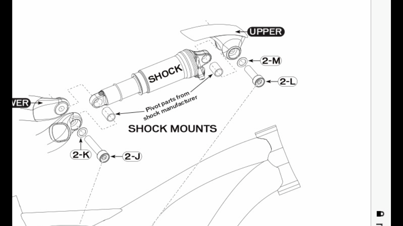

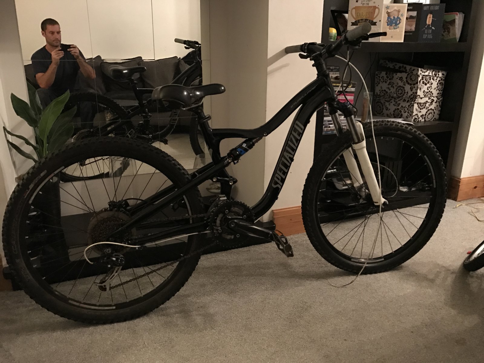

It could actually be the shock eye which is an expensive fix. the other option which might be possible is to replace with a needle roller kit as they can sometimes take up the slack.I'll do that, thanks
The bushes are plastic so could be worn.

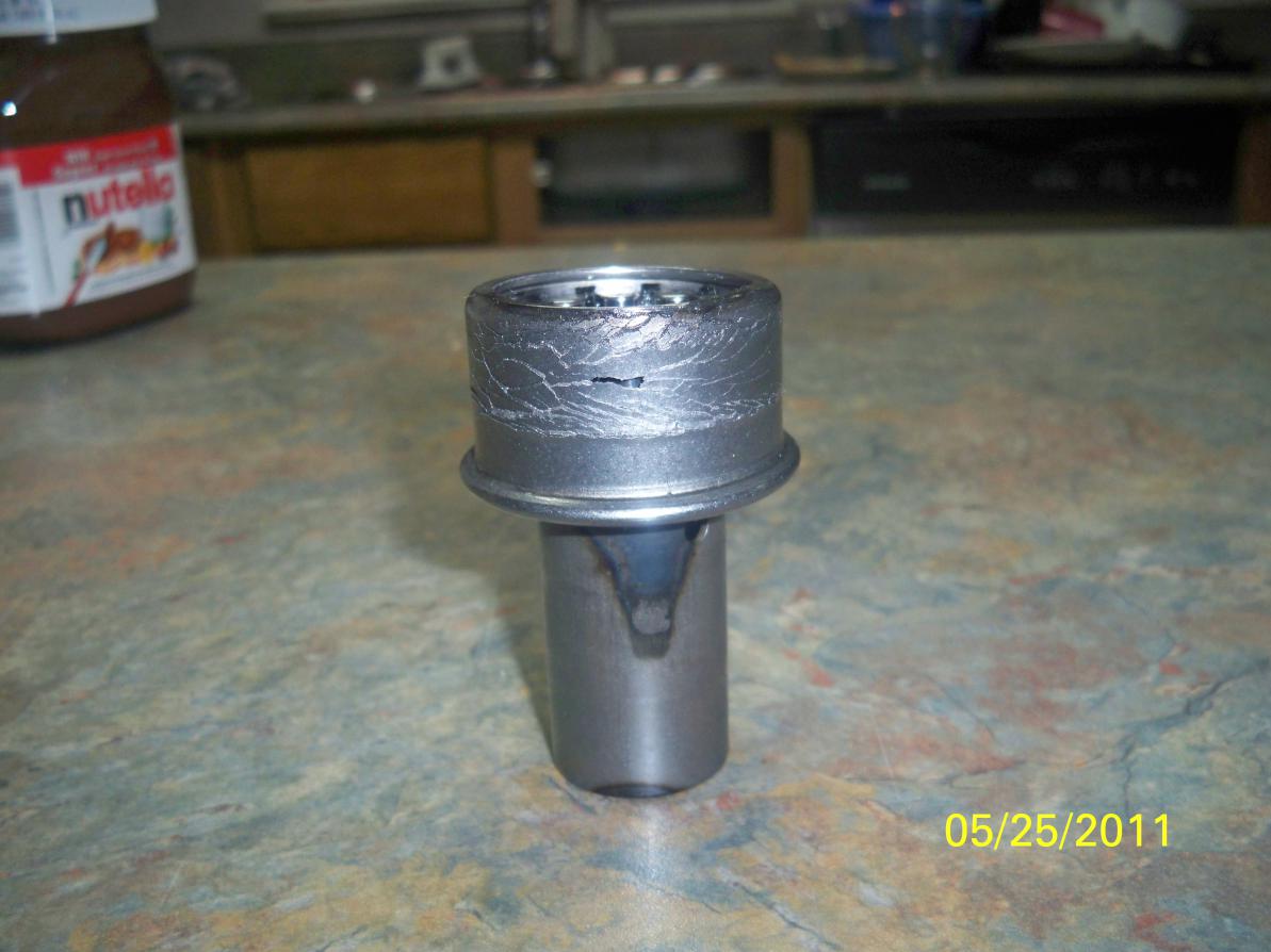

Got to be a difficult one to make .....don't think I've ever come across one.
