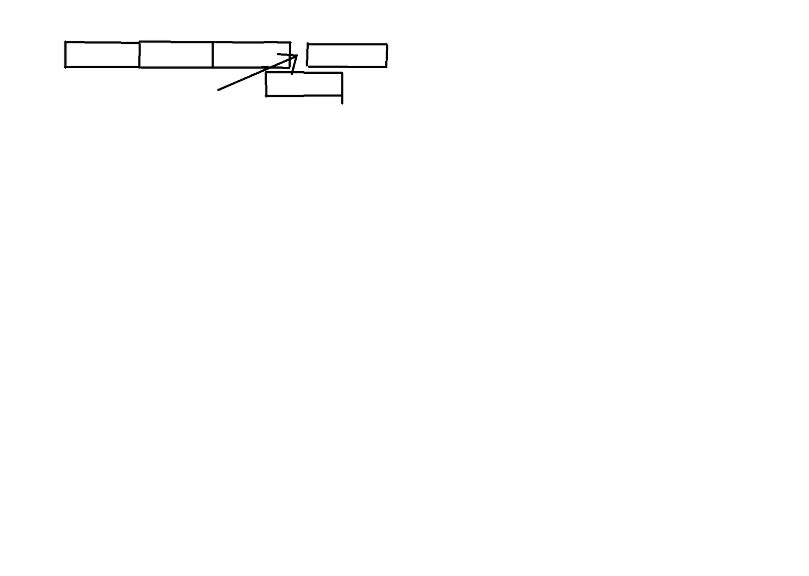

Hello All
I am digging a rectangular trench for a greenhouse I intend making.
I'm thinking of laying 3 to 4 inches of concrete in the trench. Do you think I should pour that onto a layer of agregate/hardcore or straight in please?
Then, a membrane then a timber frame, then paving slabs?
What do you think? Hoping to hear from some kindly person.

Ideally you’d want the footing to be wider than brickwork. 75mm wide footing won’t really be wide enough. it may be difficult to line up with the bricks depending on how neat the trench is.
Really you could do with 200mm, so you’ve got some weight to the footing.
Why not a 300mm wide, 100mm deep, sat on compacted hardcore/aggregate.
You could then lay a block border, by laying the block on its back. Would give you a wide 215mm base, and around 110mm high... which will give you options when you build the framework.
What are you intending to build the frame out of... size wise?

Forgot to say, you could leave a gap between some of the blocks for ventilation, presume your floor will be wood?
That way, whichever direction the wind is blowing it will circulate and blow away damp.
I’d lay a sheet of dpm on the ground as well, just weigh down with bricks.
good luck (y)
I'm thinking of laying paving over a membrane.
A gap? Do you mean like in my little drawing (Attachment)?
