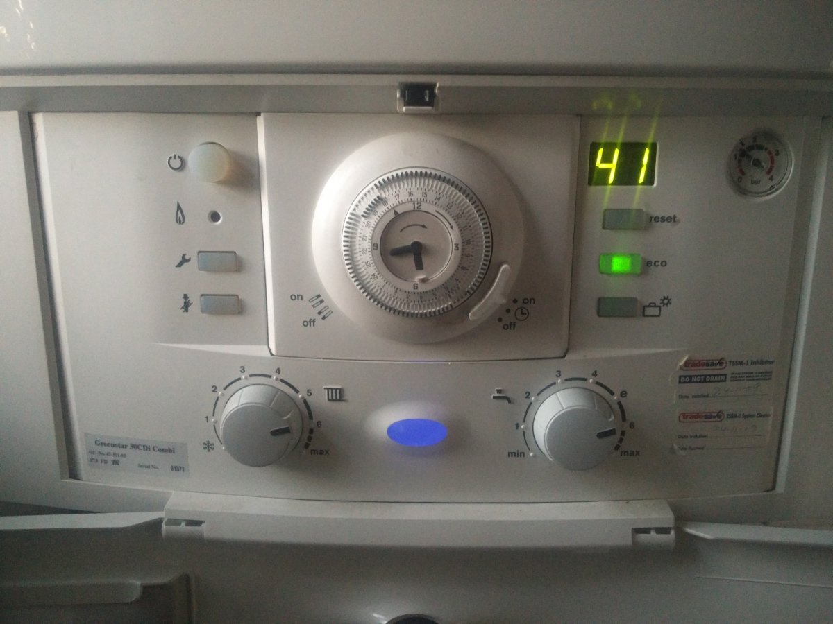

Hi guys
The green light no longer appears on as a consequence we aren't receiving any hot water at all!!! Highly frustrating
Does anyone have any ideas what the problem could be?

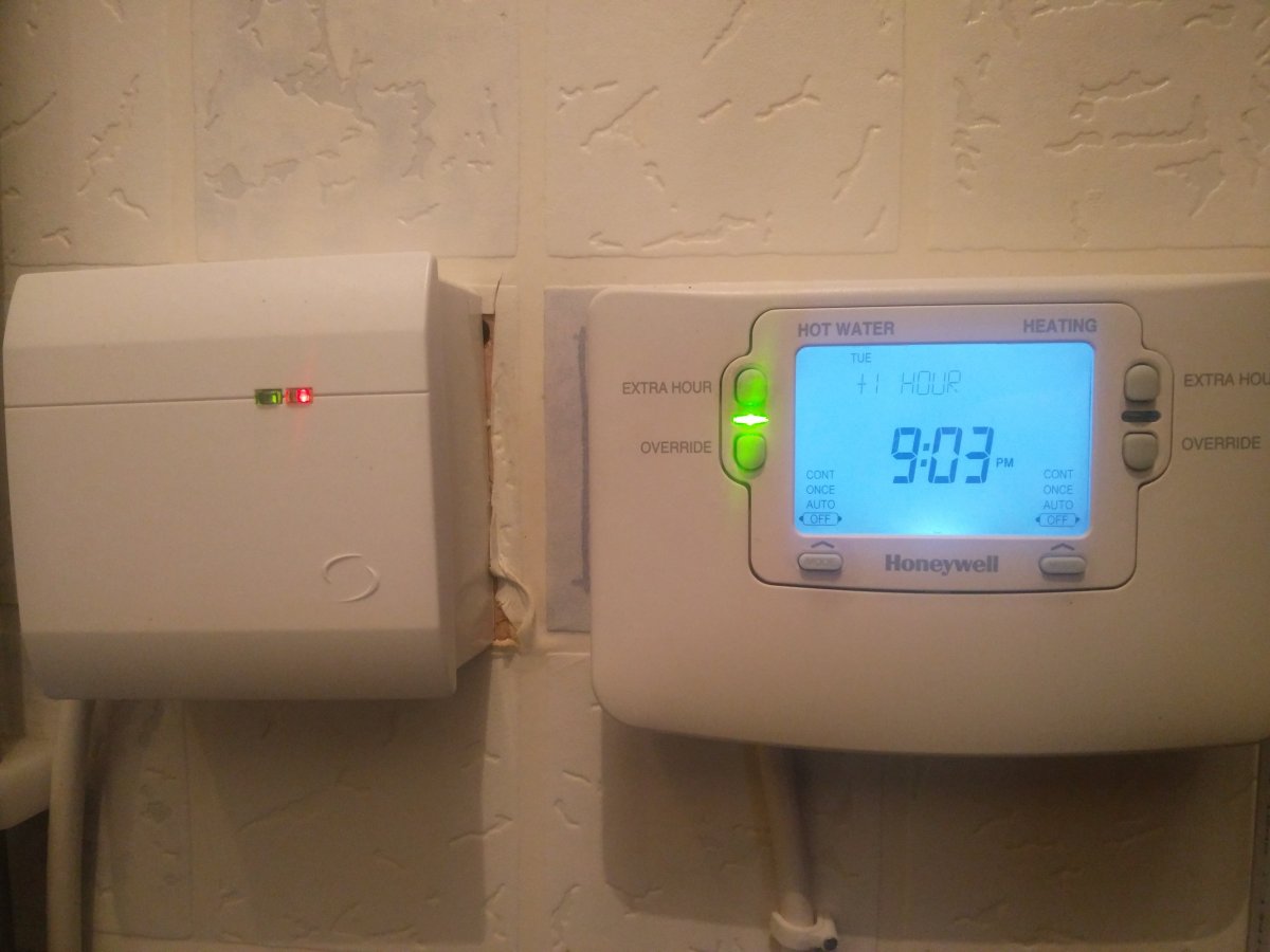

I have taken a picture of the boiler and the thermostat (this is for putting on the central heating or hot water on). When we do put either one on, that's when the green light appears.

Does it fire up for central heating?
What happens if you turn off the ECO mode?
OK, I've read your post three times now and concluded that it's largely gibberish. Try to be more descriptive, starting with which green light you're talking about
Muggles! Apologies old chum, the green light that indicates that the burner is on. This light normally appears on when i put the hot water on by the thermostat. Separately I notice when I chose to put the heating on the light does appear on.
I just put the eco button on to see if it helps the situation in any shape or form....and it doesn't. It is normally off.
OK, I think I understand you - you're saying that when you turn the hot water on on the programmer, nothing happens? If so, go into the user settings and turn the backlight off. If that works, your Honeywell ST9400C programmer is most likely part of a dodgy batch that had rubbish relays on the PCB. Honeywell should honour the warranty as it's a recognised manufacturing defect. Search the forum for ST9400
So it does not recognise the demand for hot water. Are you certain that it does not try to fire up, however briefly, when running the hot tap with ECO switched off?
Sorry If I come across really stupid. But I have no idea about boilers. But how do you turn the backlight off on the Honeywell? Bare in mind Muggles, when I use the programmer to turn on the heating I do see the green light (the burner) appear..................so not too sure if it is the programmer?....

OK, ignore the heating, it's the hot water that isn't working if I've understood you correctly? ST9400C User Guide Page 13 to get into installer mode, then Page 12 to turn off the backlight
Could also be an issue with your Megaflo but you need to be G3 Registered to work on that, and I think the programmer is the most likely culprit

Bin the British Gas cover - you're better off putting the money to one side in your own account for when a fault occurs, and employing a local independent as and when needed. You'll find that over the years you've saved enough money to replace the boiler when the time comes - boiler insurance policies are only there to benefit the insurer, and yours have already demonstrated a lack of knowledge on this very common issue. Try the backlight suggestion and report back - now that we know this is an intermittent fault I'm even more confident that the programmer is the cause

The Honeywell is a very good timer, they just had a faulty batch. Warranty is the statutory two years unless otherwise stated, as with all products you buy in the UK. Honeywell have been known to honour the warranty for the faulty batch outside this period though, and I'd recommend replacing it with another ST9400c if it is the problem.
