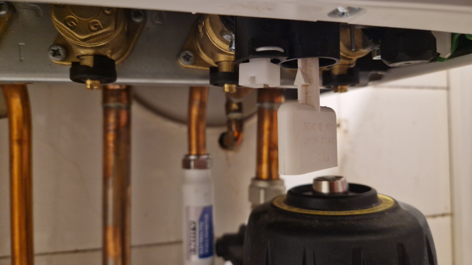

Looking for help - I've got a Worcester Bosch Greenstar boiler, 3 months old, that I can't repressurise.
Any help much appreciated, evening temp is dropping fast and we're getting chilly...
Thanks!
I just bled a radiator for about 10 seconds, and after that the boiler's pressure had dropped to zero from ~1 bar.
But when I tried to repressurise it for 5-10 seconds, I heard water flowing but the pressure gauge stays at zero. Photo of the filling loop key (now back in default position).
I switched the heating on and the radiators started warming up but there was some weird noisy gurgling coming from the pipes under the boiler so I switched the heating off again.
Any ideas why it won't repressurise?
The key should be pushed fully upwards and turned until it locks into position.
Then you turn the small white ,square, clockwise a full turn.
Is this what you did ?
May take more than 10 seconds.
Thanks for the replies, appreciate it.
I've sorted it out now - I just needed to turn the square valve much further.
Thought I needed a plumber but was just being a plum :)
