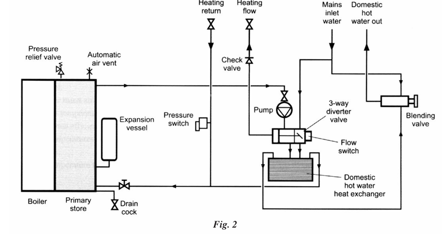

Schematic below from a Grant Combi with one circ pump + Diverter valve, which I imagine is similar to yours, so if the store is kept preheated wonder what temperature probe? as the store is only primary water and not a DHW store and looks like its just used as well when the CH is on.
Apologies, its not I think as the heating flow and return come from the main heat exchanger
Edit: If not electrical problem maybe worth checking those non return valves for failure/leakage.

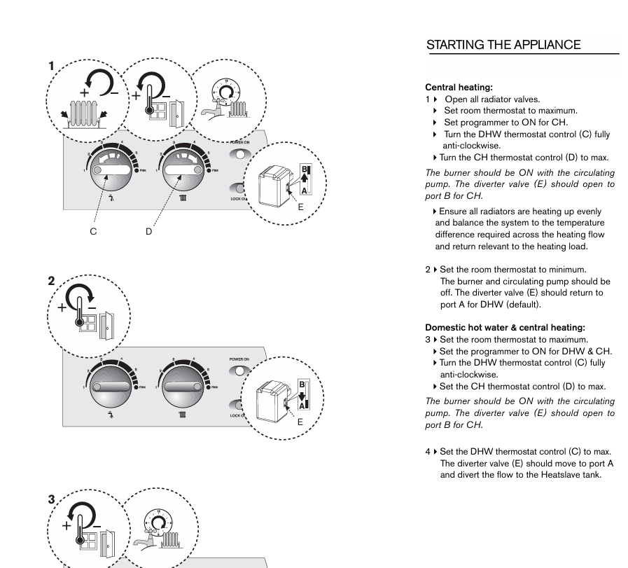

I notice the Diverter Valve Ports A & B go respectively to DHW & CH, and CH, Port B, is the default position, see 2 below, if so, why do you have to.... "manually move the diverter to heating it warms the radiators" ?
I think A is default (DHW)?
I manually moved it to B and locked it in place to test the overheat issue on CH.
