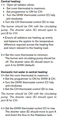

When turning the boiler on the timeclock is calling for both hot water and central heating with the priority being hot water. The heatslave tank heats up to the setting on the hot water thermostat. When turning the hot water tap on the diverter valve immediately moves from 'port a'(hot water) to 'port b' (central heating) with the result of no hot water. This happens even when the heatslave tank is full of hot water.
I have already changed the timeclock, flowswitch and diverter valve which hasn't fixed the problem, as soon as I turn on the hot water tap the diverter valve switches to 'port b'.
The model is a oil Greenstar Heatslave 12/18.

As Hairynipples pointed out …..Port a is Heating.
The valve is closed by spring pressure to portB for water demand.... It is a divertor not mid pos'n.
Have you fitted correct valve / actuator

No, the hot water does not work if only that is selected when the tap is turned on.
The HW heats the heat tank up until thermostat is satisfied, then switches the boiler off. The heat tank does come up to temperature when asking for HW only. The problem being when the hot tap is turned on the diverter vavle moves immediately to port b acting in reverse order, at all times when the hot tap is turned on.

In the service manual for the Heatslave oil 12/18 it states under Diverter valve: 'Port A' is Domestic Hot Water and also the default position. 'Port B' is Central Heating.
Check the part no of the pcb is correct. I recall a problem I had some years ago where things worked in reverse and it was because I had the wrong pcb
