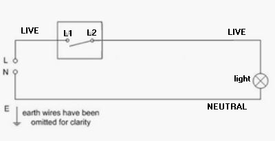

Replacing kitchen and changed to grid system (Nexus) Installed outlet for cooker hood going back to fuse module. Taken feed from back of socket to the module and on to outlet but fuse only has 2 terminals both marked L. So I have a live a neutral and an earth coming from the socket and the same from the outlet. The fuse is inbetween. What goes into both L terminals on the fuse holder. I thought just the lives (1 in each terminal) and connect the neutrals and earths with connectors but not sure now as an old MK holder for outside light has live in L1 and neutral in L2. The Nexus is only marked with 2 x L

Correct. Bearing that in mind...
What makes you think there is a neutral in L2?
What is a neutral?
Exactly.
Neutral is the name given to the conductor which completes the circuit from the load(light) back to the supply.
It is not a generic term for any Black or Blue wire.
Wires can be anything we want them to be; they do not know what colour they are.
...and Risteard will tell me that the neutral is also a live conductor, but one lesson at a time.
