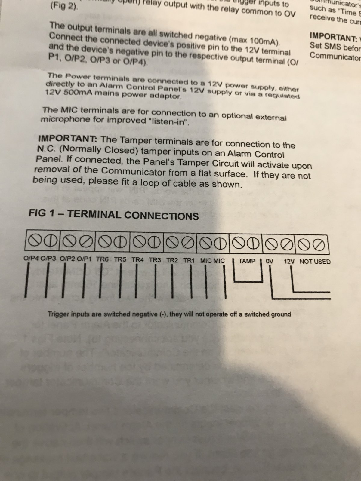

All,
Looking for some advice. I have bought a GJD710 gsm dialer (getting a phone line to the panel was going to be a mission).
Question is the manual isn’t very clear on how I connect it to the panel.
I have a texecom premier 48 alarm I will upload a pic of the terminals on the dialer just confused as to what to connect it to on the panel. If someone could guide me into what I connect from the panel to the dialer terminals I would be eternally greatful.
Thanks in advance
If you simply want to know that the alarm has activated, connect the 12v and 0v connections on the dialer to the 12v/0v Aux connections on the panel to power it. Then, connect the bell output on the panel to TR1 on the dialer.
