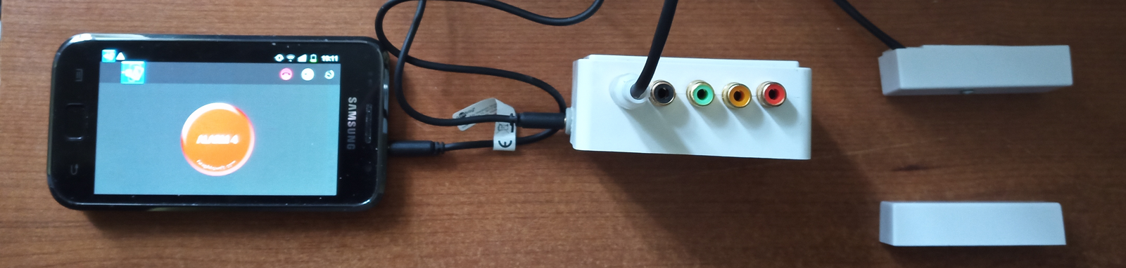

An old android phone can make the job. If the alarm has an Open Close output, it can be plugged to the jack audio of the smartphone and make an automatic SMS or CALL. You car search for “Wired headphone Dialing Alarm” or look at alarmD
