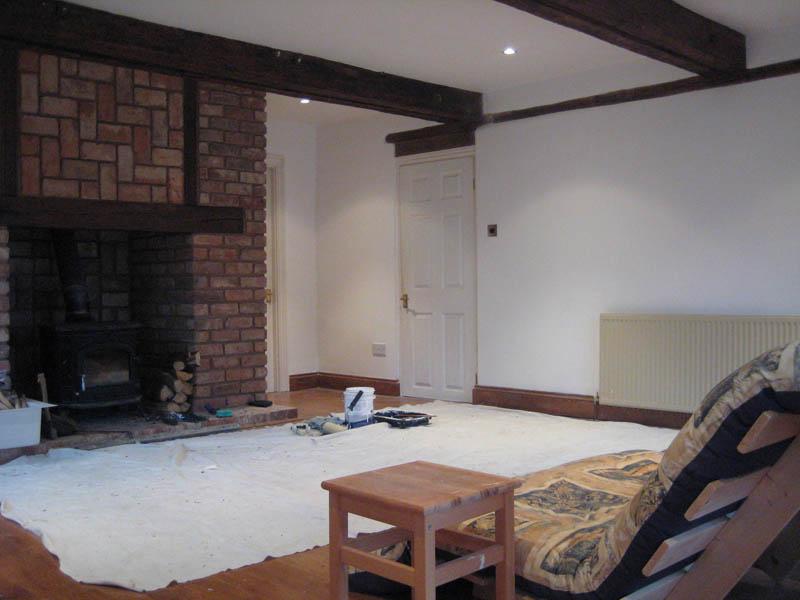

Not a chance. We ran PELs in relux and the room was dark and dingy. didnt even hit 50Cd on the foor. We have beams which extend about 9 inches below the ceiling creating some pretty big shadows. This was why we had to go with lots of spots.
That was my original point; unless you plug your intended layout in a raytrace suite such as Relux, you wont have the slightest clue what its going to look like unfortunately... We ran it with lamps +PELs, Halogen + Lamps, Pendants, nothing worked, unless we went to matt white walls and wide angle floods.
Give you an idea, this is it painted, pre-cleanup.
We are going round and retrospectively removing the downlights they have put into the bedrooms, completely pointless in a lot of respects and we will bereplacing with simple pendants.[/img]
