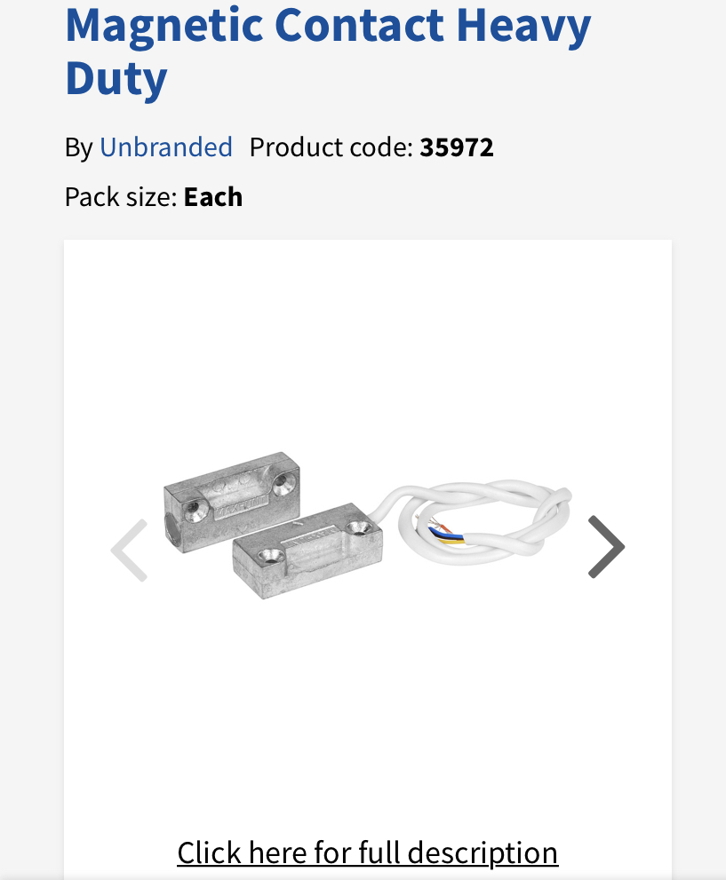

trying to protect the garage from intruders forcing the garage roller door open as the rear entrance is cover by the original pir
Could I just fit a simple magnetic Reed type switch to the base of the door that is NC when the door is shut and then wire the switch in series with the yellow pir alarm wire so if the garage switch is broken it breaks the yellow wire signal back to the control box

I would try the 1. 9. Yes no ….first ….DO NOT try the other reset options ..you may need someone else to power up the panel depending on the keypad location …
