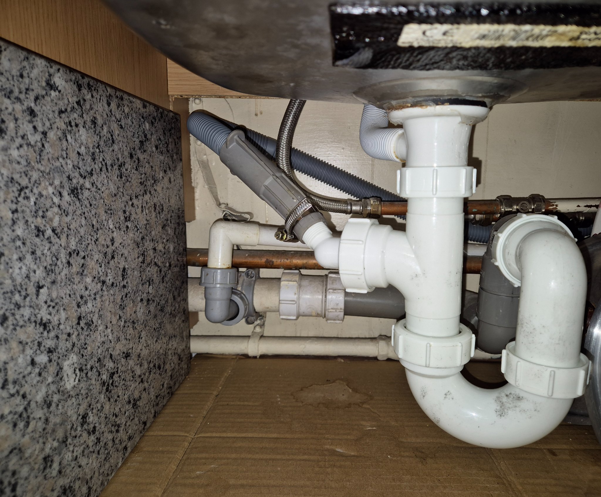

I believe so - after cleaning the pipe, spin cycle runs as normal. I don't have a great deal of flexibility with the pipe and can't reroute it any way. See attached picture.

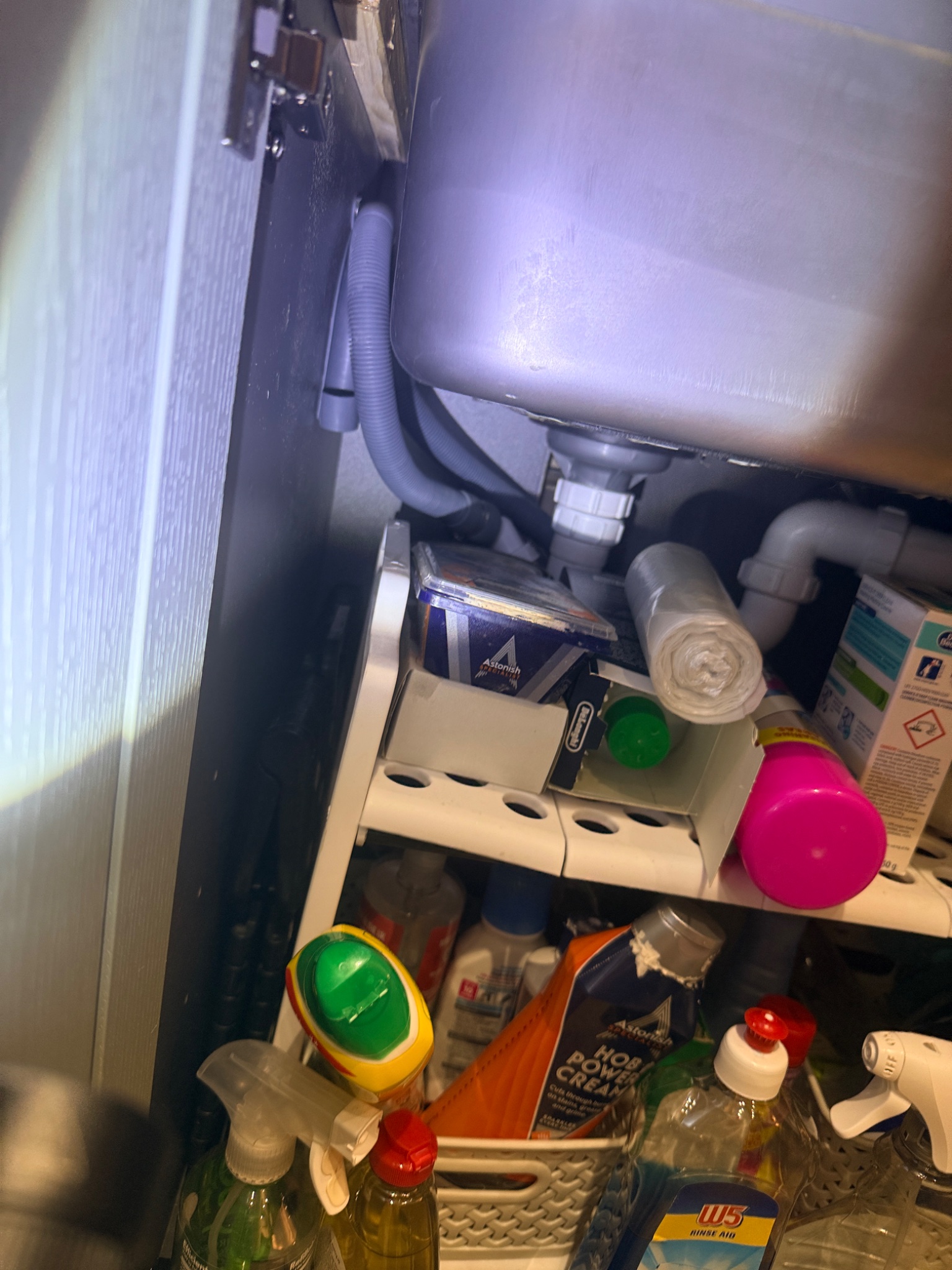

See attached picture of waste. Please also see my reply to CountryFan above re old soap being pumped out.

I've been monitoring washing machine performance after raising the pipe and checked everything again today - so far no sign of any blockage. I'll continue keeping an eye on it but preliminary signs are it's problem solved. And to think the solution was so simple!
