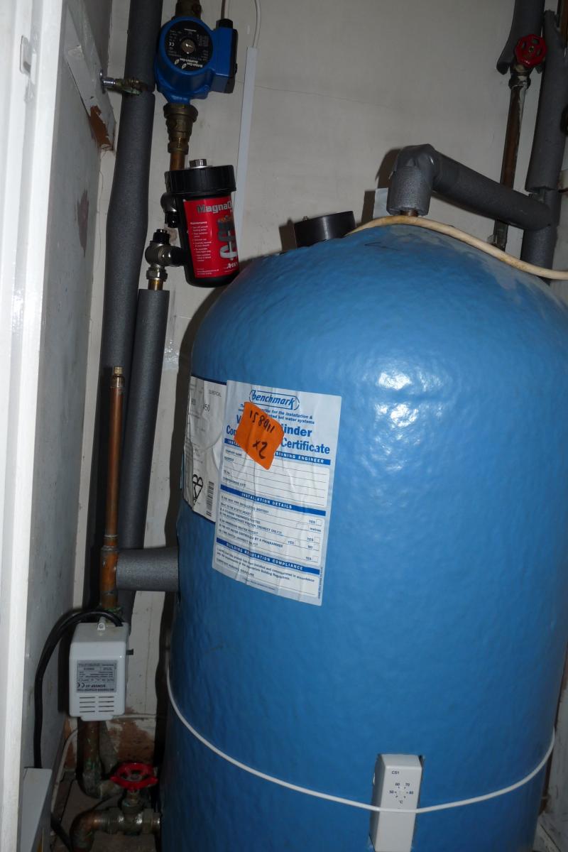

ok, i have been having more of a look at this. Here is a picture of the pump arrangement.
the right hand pipe is the feed and the left the vent.
This is the arrangement lower down.

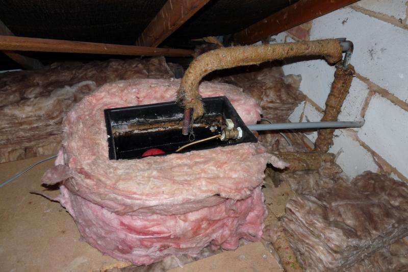

I have now managed to stop it pumping over. The vent pipe looked to be going downwards towards the tank. I found if i moved the pipe up slightly it didn't pump over.
This then stopped most of the gurgling and now i just get a slight water running noise when the pump first comes on. almost like someone is pouring water down the pipe leading to the boiler.
All i'm wondering now if I am just masking the problem and there is still a problem somewhere. The boiler is a Potterton Promax 15 SL if that makes any difference.
If anyone could put my mind at rest I would appreciate it.
Many thanks
