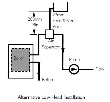

If your boiler has overheat protection, stop all the ifs, buts, and maybes and pipe it like this........ View media item 29821Looking at your pics it's about an hours work and no air will be drawn into your system.
Thanks 45yearsagasman. This had been suggested before by the person who serviced the boiler. I was worried about safety of the system if something fails. So was thinking of T-ing the feed in to the vent, so that I still have a vent from a safety point of view, but not sure it this would cure it.

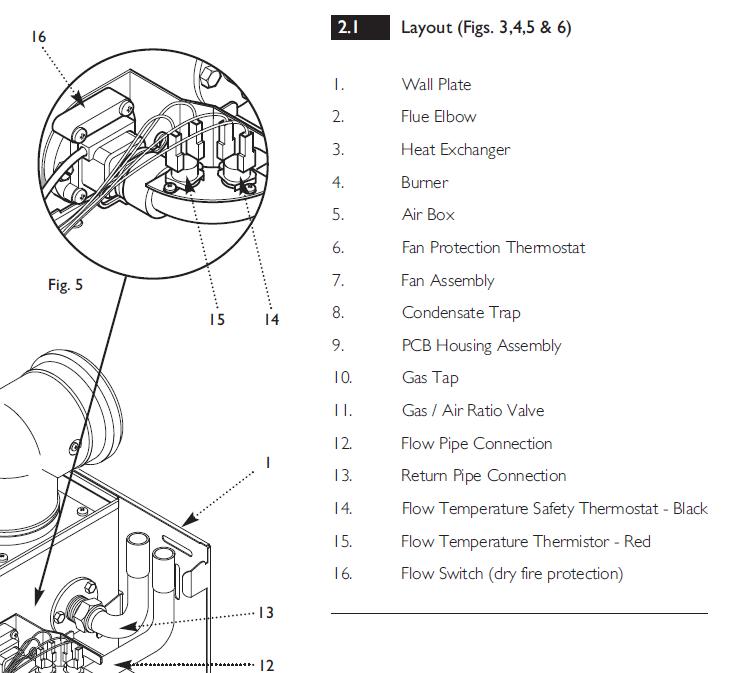

The boiler is a potterton promax 15 SL. I know it has a flow sensor and a flow temp sensor. I think it does have a over heat protection, but can anyone confirm for me please?

Just found this in the instruction manual for the boiler. Do I need an air separator? Or does this do the same job as the vent on the 15mm pipe as in 45yearsgasman's post.
Also found this
I presume item 14 is the over heat protection that you refer to?
Thanks for everyones help on this.
Can anyone confirm my questions above please? Hoping to combine the vent and feed this weekend.
