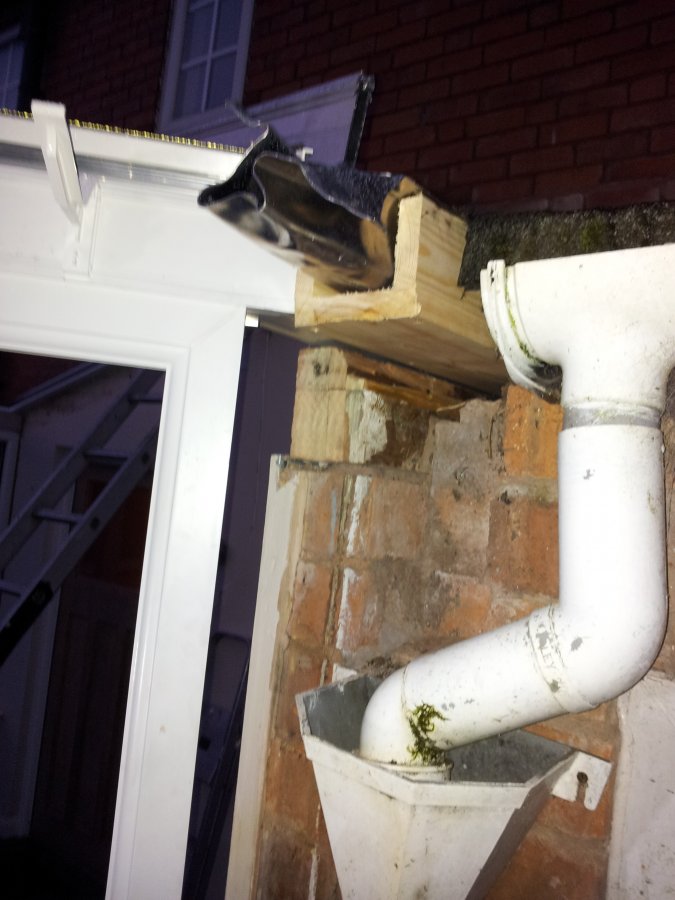

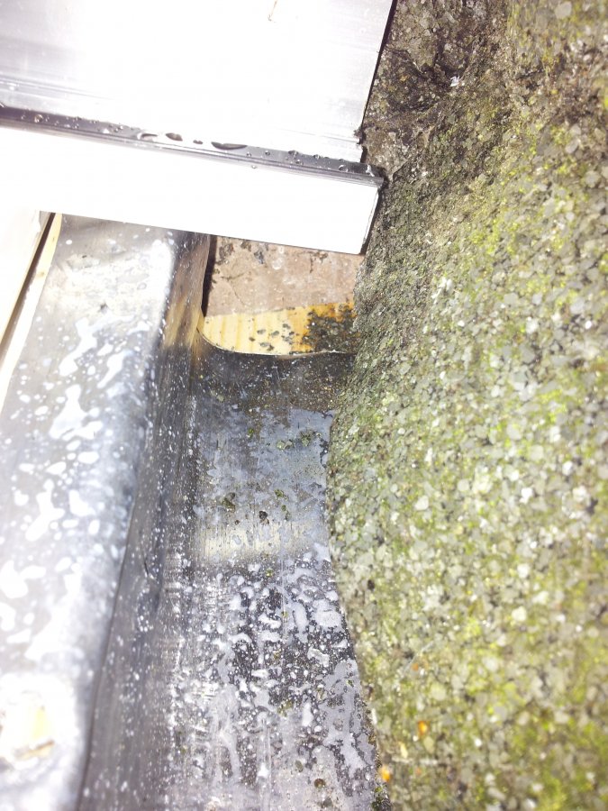

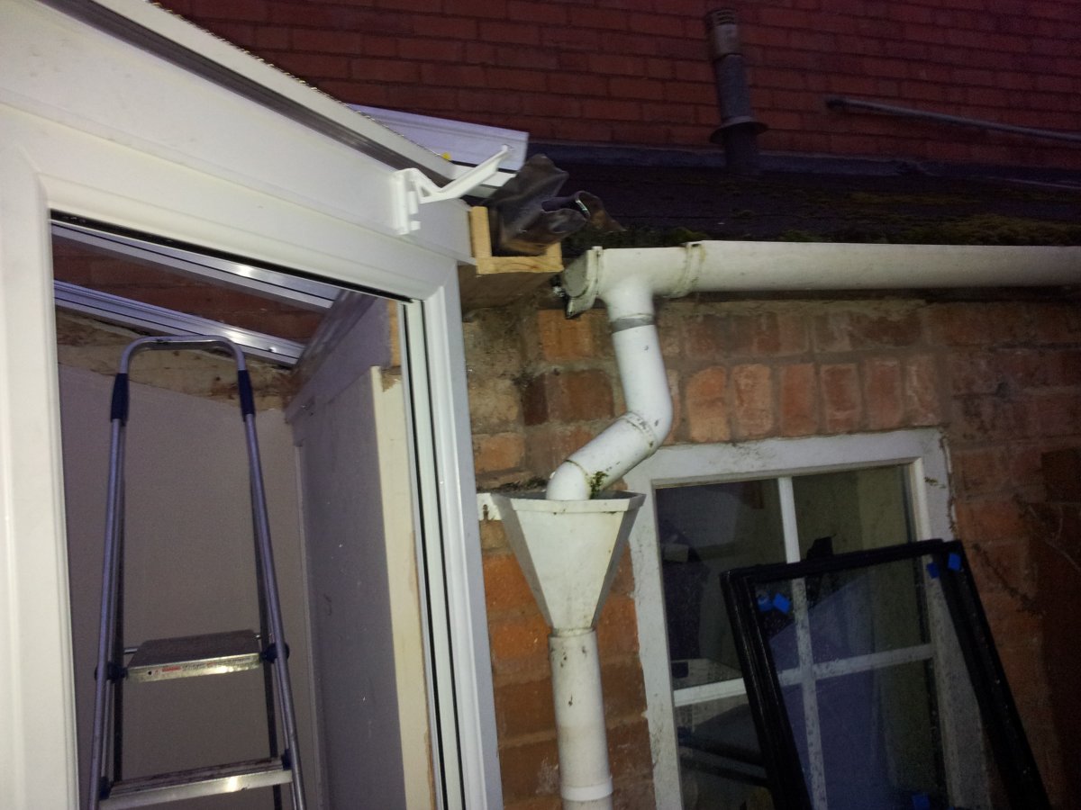

I am having a conservatory installed which originally included a bespoke 297mm aluminium wide box guttering between the conservatory roof and a flat sided felted roof at the side. Without consultation the bespoke box guttering has not been used rather they have created a narrower wooden box gutter (125mm) lined with lead flashing. It does look like they have miscalculated sizes. The felt from the roofing has been then draped over it and I am not sure how this will be finished but appreciate advice on how it should be done. I am concerned that the soft wood is exposed at the outside end and there is also no flashing end built in against the house wall to stop water finding its way to the house back wall along the felt and exposed wood despite a drop being built in.
I have attached photos and would appreciate comments as to the current work and how to rectify. I have so far established that there are ready made metal box gutters and ends which would fit the gap.
Thank you for your time.

Difficult to say really as it's unfinished, maybe give them a chance to get it sorted first.
Why not post photos that give a context of these two roofs - & pics taken standing on the flat roof looking down at the join and the flashing you complain about?
Are both roofs on your property?
As above, its a work in progress but there are one or two troubling areas?
It's certainly unfinished, but that's not to say it is an unfinished bodge.
