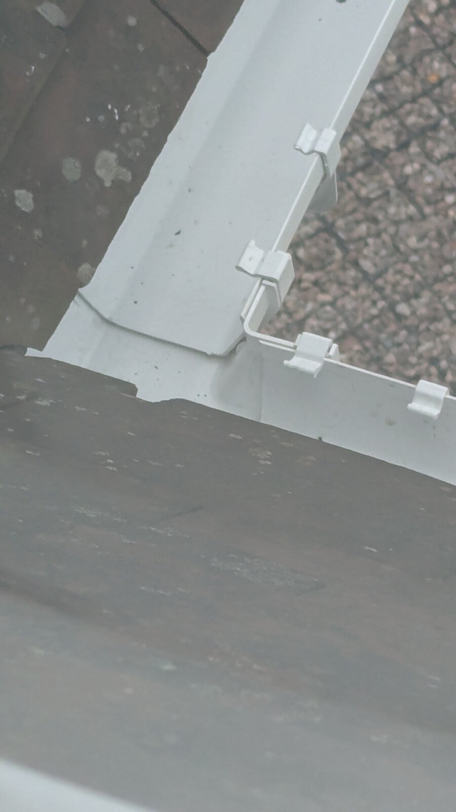

Hi
I recently had new gutter installed and all the corner joints have been installed as per the photo attached.
Water running from the right on the photo.
Is this installed correctly? I have my own view but don't want to prejudice your responses.
Gutter a bit too far in. Needs maybe 10mm cut off.
Corner bracket should have marks showing when gutter should be..
