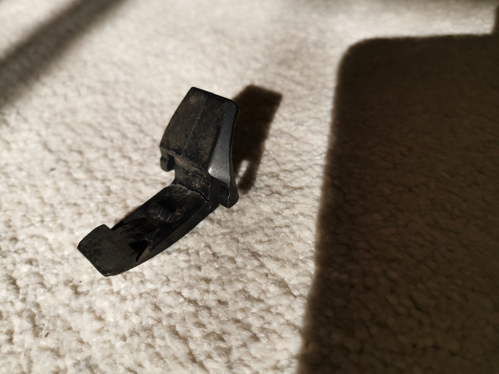

Good morning,
Noticed with the recent storms I had a leak from one of the union joints from two bits of horizontal guttering.
Looking today the clip that holds the gutter against the has fallen off and other further along the roof is broken. I'm hoping someone can identify these and point me to replacements rather than having to replace the union joint.
This basically clips into a groove on the union joint then under tension onto the top of the gutter.
I have broke these putting new guttering up. Just take the clip and compare them with ones at Wickes Screwfix on a gutter bracket. They do pop off so you can just buy the braket and use the clip off it.
I've seen those clips on FloPlast before from Wickes.
I have also bought "identical" FloPlast guttering from Wickes which has a completely different type of clip on it - which actually I prefer - but if you're wanting to replace the clip without removing the union, nip to your local Wickes and see if it's this type they have in stock.
