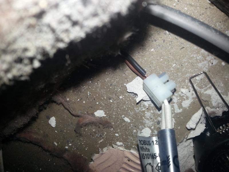

When I went up I saw he's removed most of the insulation above the bathroom, none of the wiring is attached to the wood, exposed copper wire is near the insulation and he's cut some of the wood to fit a down-light in.
Does this look safe to you? Should I ask him to come and tidy the job up?

That's dreadful. I cannot see if these are 230v or 12v lamps, but even so.:
All terminations must be inside enclosures. They come with the light fittings, why didn't he use them?
The maker will have specified a minimum distance from joists etc, so that light needs to move.
And that rats nest where all the wires come together is unsafe. Again, all of the cables and terminations must go into a proper enclosure that is screwed to the structure, not just floating around in the air.. Cables must be clipped to backgrounds.
Edit, he IS meant to clear insulation from round the lights, or they will cook.
If you plan to cove over with insulation, then you'll need to install something like these:http://www.tlc-direct.co.uk/Products/JC94020.html
I'm not a pro but that looks pretty shoddy! bare copper visible outside of the block there and the connections should really be in a box of some kind.
Did he give you any kind of documentation or certificate?

I've just been looking at those from a recommendation in another thread, I'll definitely have to get some. I expected some insulation to be removed, but it's been taken out of the places it needs it most which aren't obstructing the lights.

rjm2k: He wrote this on the invoice, "All work has been conducted iaw 17th edition wiring regulations amendment 1. Where necessary amendments to existing wiring were made to conform with the regulations. A works certificate has been submitted."
I had a look and they are 12v 50w lamps

Taylortwocities, that's right - I searched for it by the part number, this is the one I have installed. Mine says 12V on the label attached to it. I don't see how they would even work?
There's definitely 240V going in to it.
Has that been confirmed by measurement?
You can get 240V lamps with the GU5.3 pin spacing that look like, and therefore fit 12V fittings.
But these fittings are designed for 12V, not 240V.
So, exposed insulated-only cables outside an enclosure, using the product not as intended, cables unsupported, and fire risk from location of downlights from combustible materials. Not looking good for this idiot is it? What paperwork did he issue, as he so proudly announced on his invoice?
mfarrow, I measured it with my multimeter at the choc block which connects to the light fitting's fitted wires.
