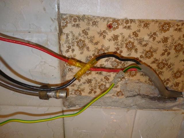

Had to remove a shower at a job today
What size shower? What size protection? Any signs of overheating anywhere?
That wallpaper is terrible! Are they maintenance free joints? Except the terminal block.
The joints were what you would normally see on car wiring.
Removed to allow area to be retiled.
