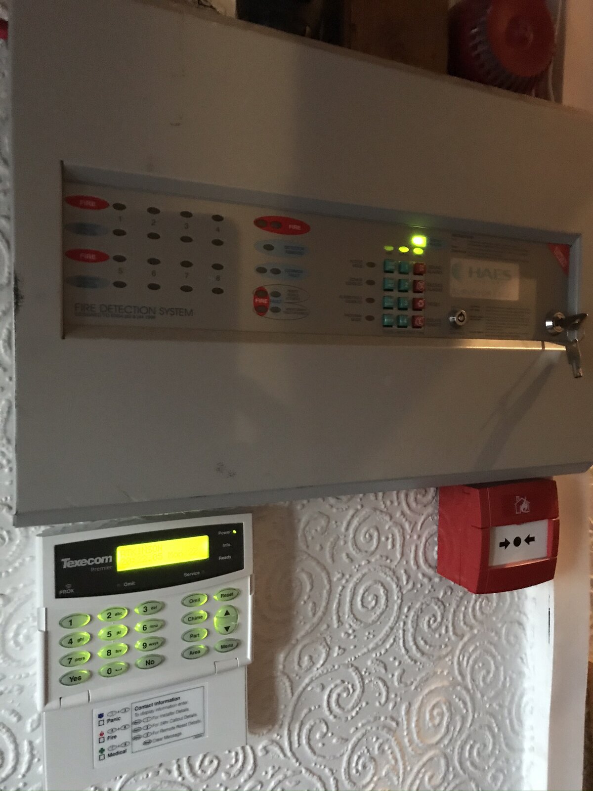

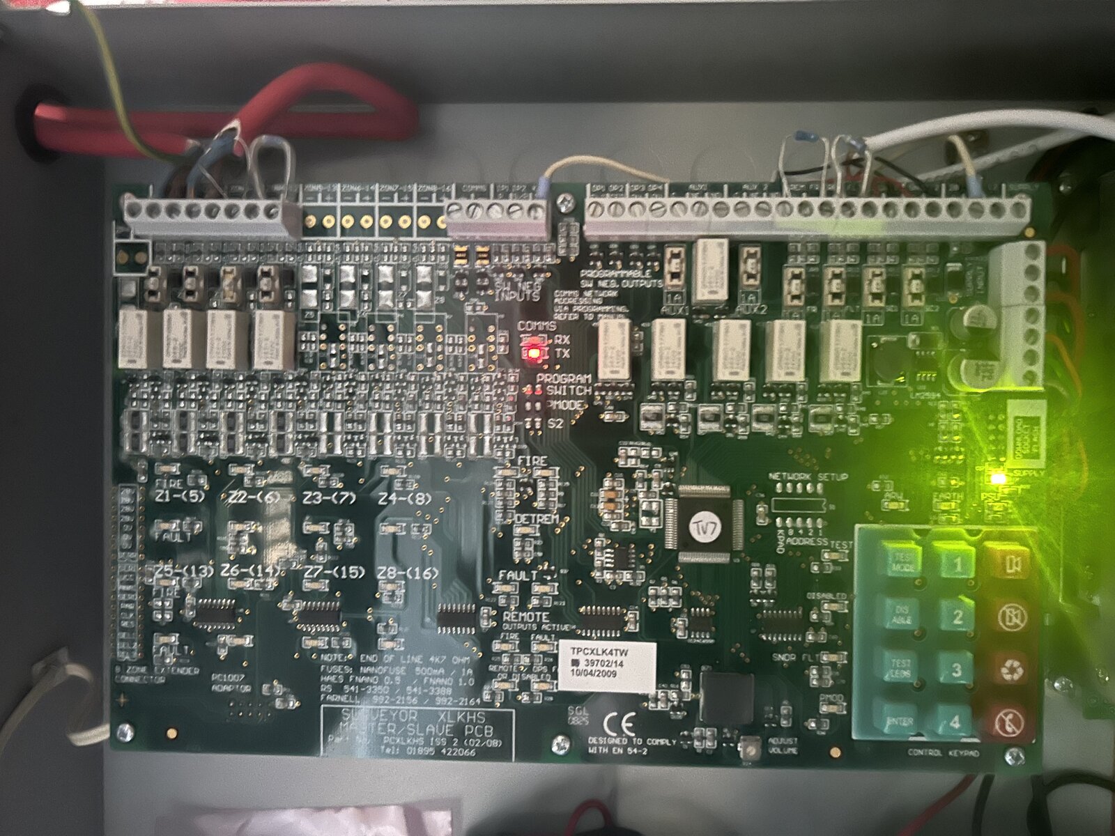

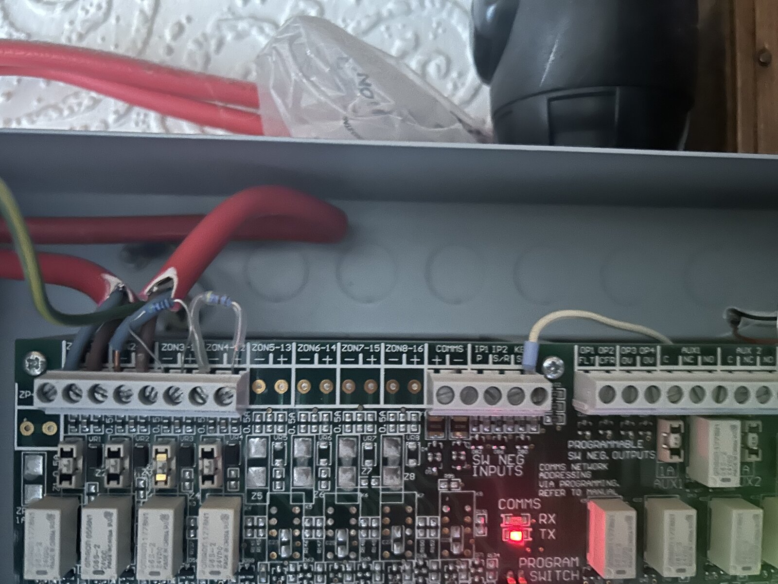

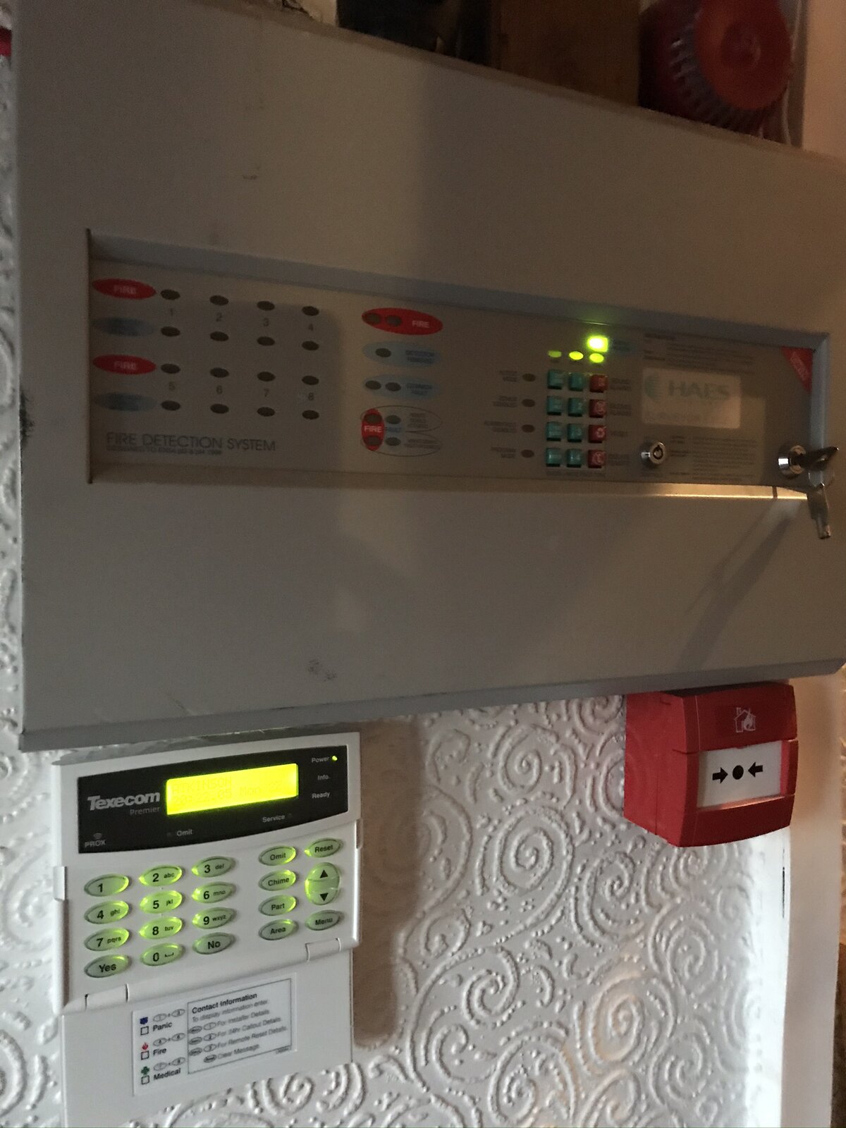

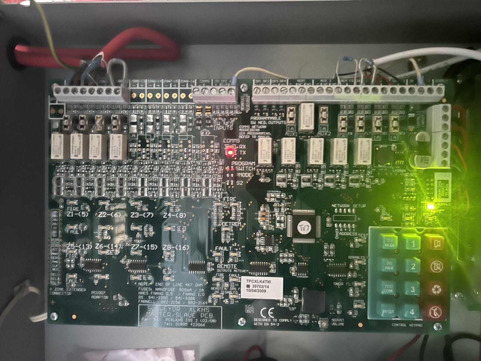

Hi all is it possible to connect a Haes fire panel to a speech dialler sd2 ?? I know the connection in the sd2 but which one in the fire panel .. thanks
This panel

The SD1also?
The sd1 uses a standard phone line which won’t be available in the near future but that aside.

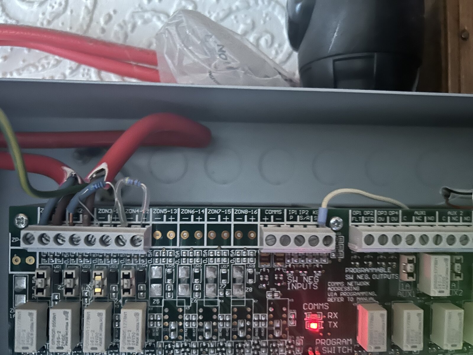

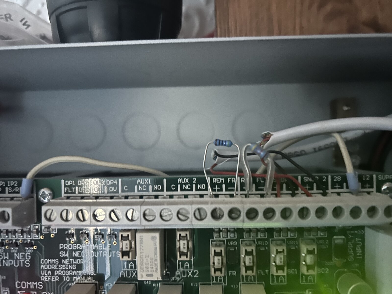

There are switches negative outputs you could wire in says they are programmable so not sure what the options are without referring to the fire alarms manual.
U need cfr output. Is the dialler powered from intruder or fire alarm?
Looks like a mouse has chewed the ends of the cable.
Safety comes first the whole thing should be disconnected and installed correctly.
Diy or not I would not risk the Safety of my family with that.
Hope you are not putting 999 in the dialler.
