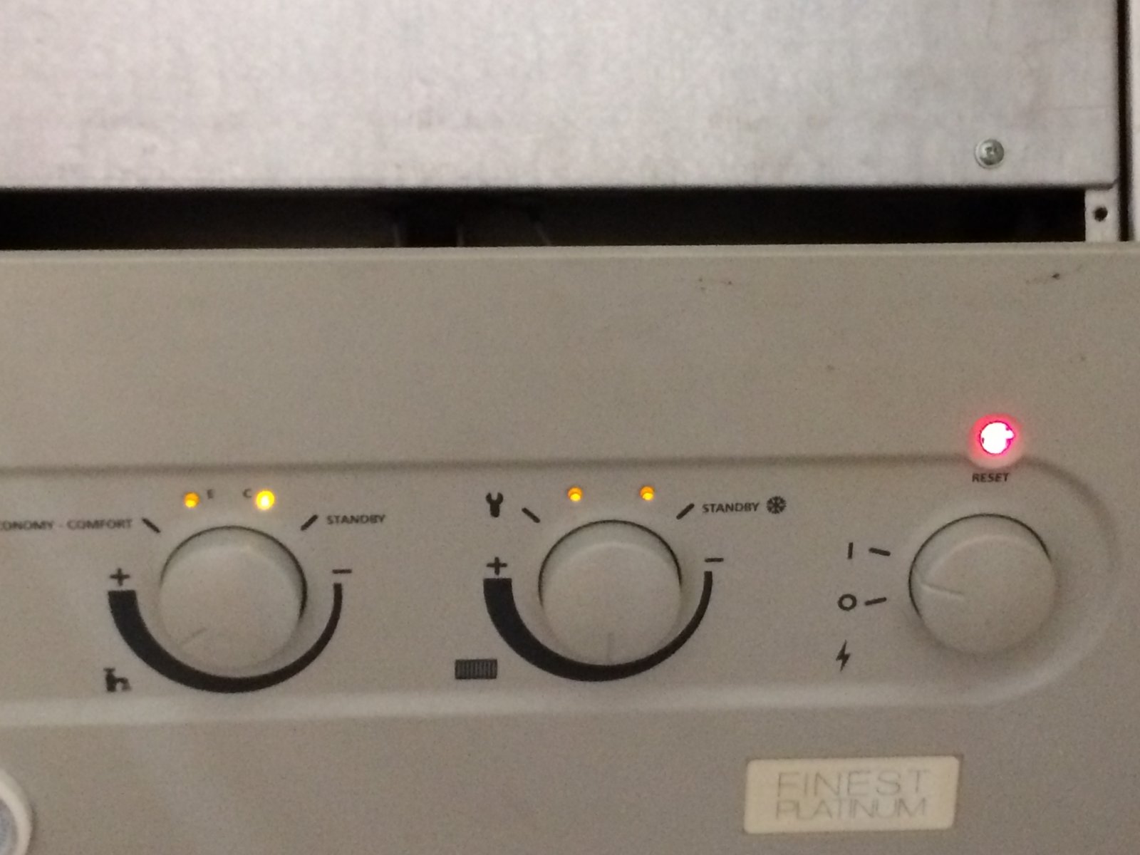

Hi. I have a Halstead Platinum boiler. The red LED light has been coming on and off intermittantly now for a few weeks. I've had two visits from British Gas.
First engineer replaced the thermistor as the boiler diagnostics indicated "Defective DHW Sensor". This did not fix the problem, red LED light was back on about 10 mins after him leaving.
Second engineer said it looked like a loose connection and supposedly pushed some connector back in. 30 mins after he left red LED was back on.

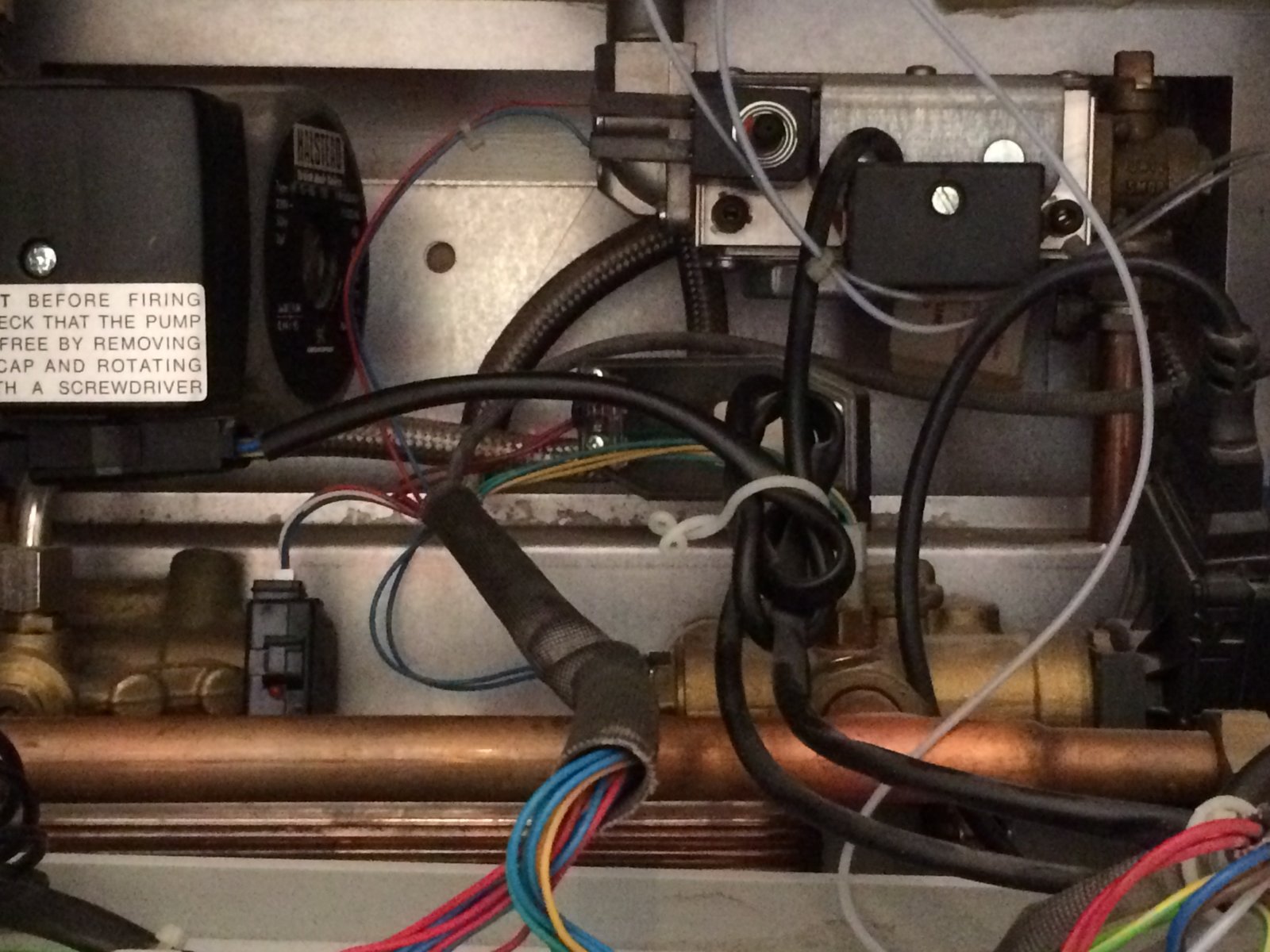

What I have found is that when the red LED light comes on and I open up the fornt of the boiler and move pretty much any wire the red LED goes off.
Any ideas?
If it's connected on the wiring harness it could be a loose or damaged wire somewhere?
Thanks. How would I go about finding that? Should I replace the low voltage loom and/or PCB? Thanks
If it's working normally whenever the red led is on or off it could be the red led or its wiring that's faulty
@sircerebus666 Sorry I miread your message. It does not work when the light is RED. Works like a dream when the light is blue.
Ah ok , you are going to have to test every wire to see if one has a break in it (I would start with the thermistor wire) check all the wire connections too
Not sure how I would do that. Also, if I wired had a break in it would the red LED not be on all the time?
Not necessarily , the vibrations of the boiler could be causing a faulty wire to break and make contact , the problem could be a faulty component , a dry solder on a PCB board or dodgy connection on a PCB board.
This is all guesses however..... Because you say you can fix it by moving any wire it does indicate a faulty wire or connection
You use a multi meter to test wires , if you're not confident in fault finding I would call back BG and tell them they didn't fix it and insist they properly check it all over this time (for free if youre paying)
