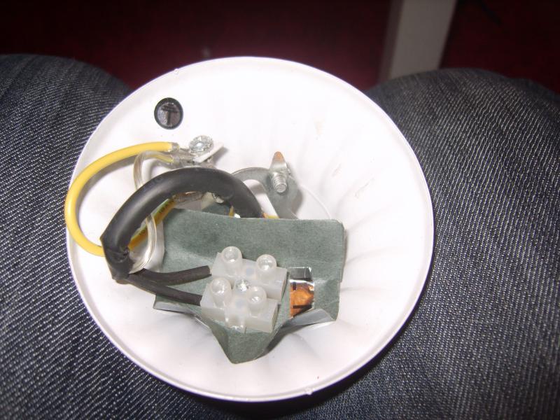

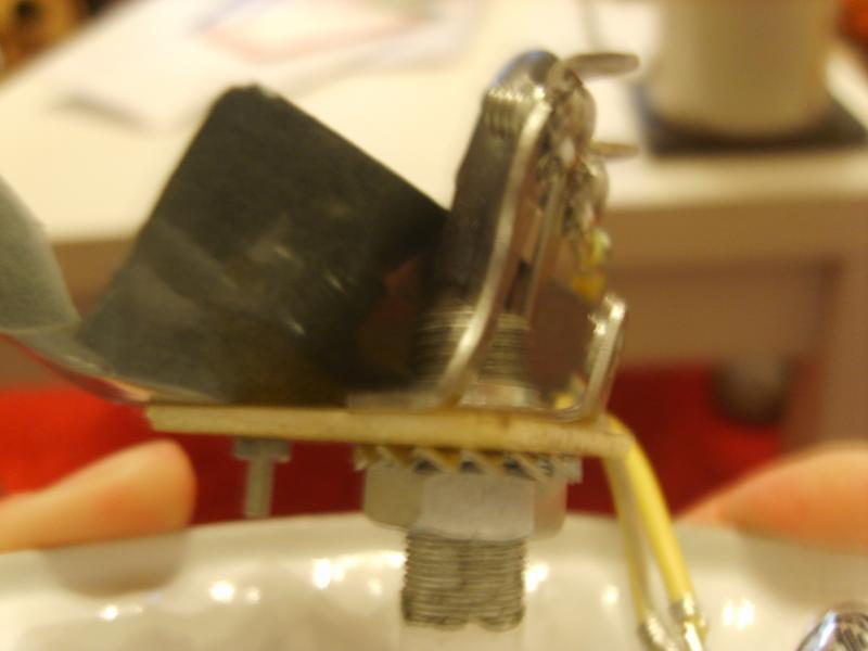

Evening All,
SWMBO has decided that it is a good idea to buy a new chandelier style light fitting for the bedroom! No issue at all with the electrical side of things and making the connections, however I have to admit that I'm completely flummoxed as to how to attach the flipping thing to the ceiling... :rolleyes:

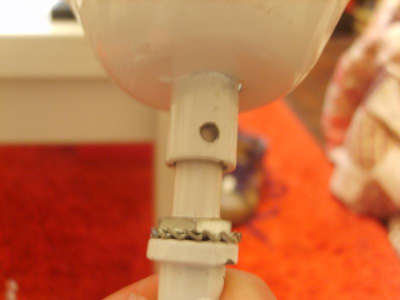

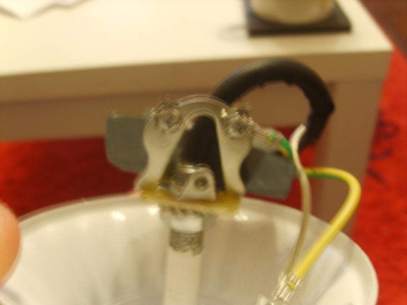

I've attached a couple of (very poor quality) pictures showing the fixings below - if anybody has come across one of these before and can shed any light it would be very much appreciated. I can't help feeling that there's something missing :(
Thanks in advance!
In picture 3 there is the loop which will hook onto your screw hook which you fix to your ceiling. Make sure you have a good piece of timber to screw your hook into then hang the chandelier.

Pic 4 should be a screw in that small hole to secure stem to top bowl so that the stem takes the weight and not the wiring.
