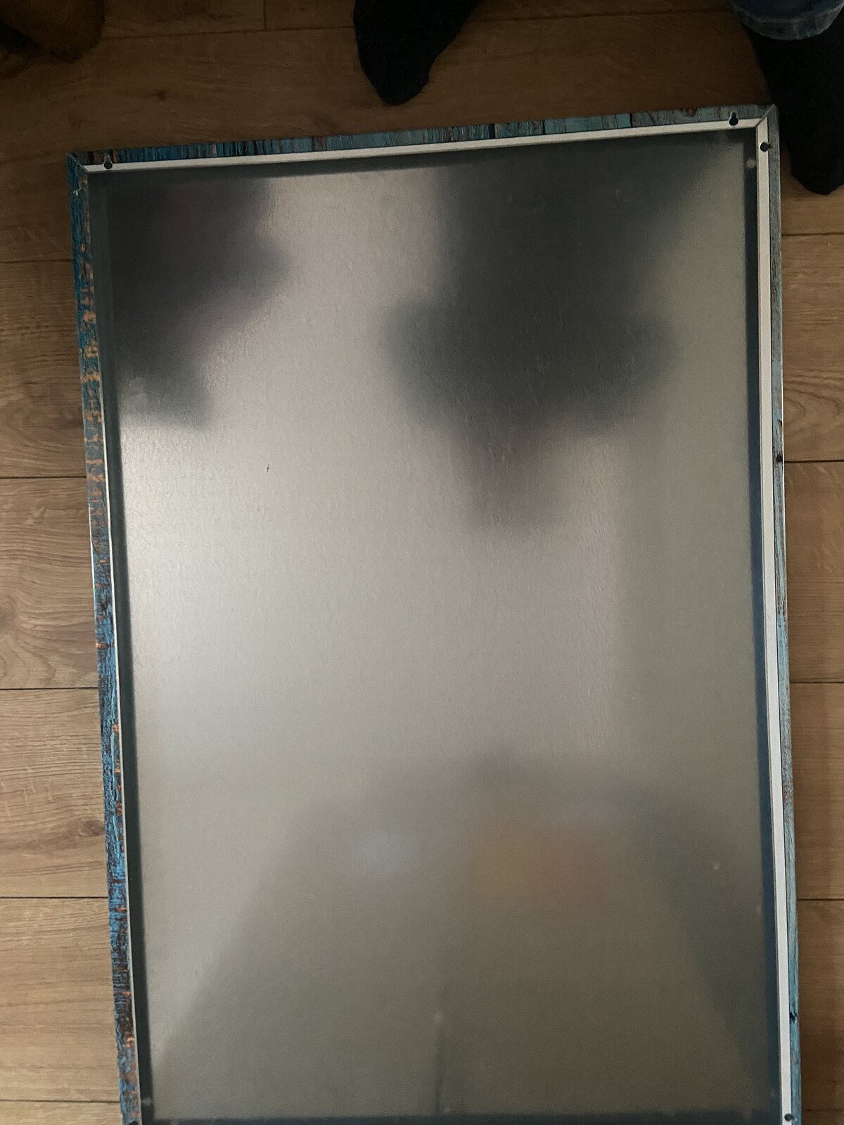

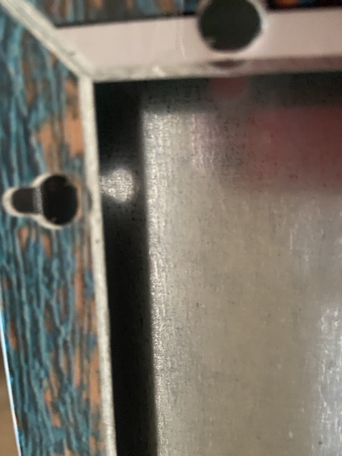

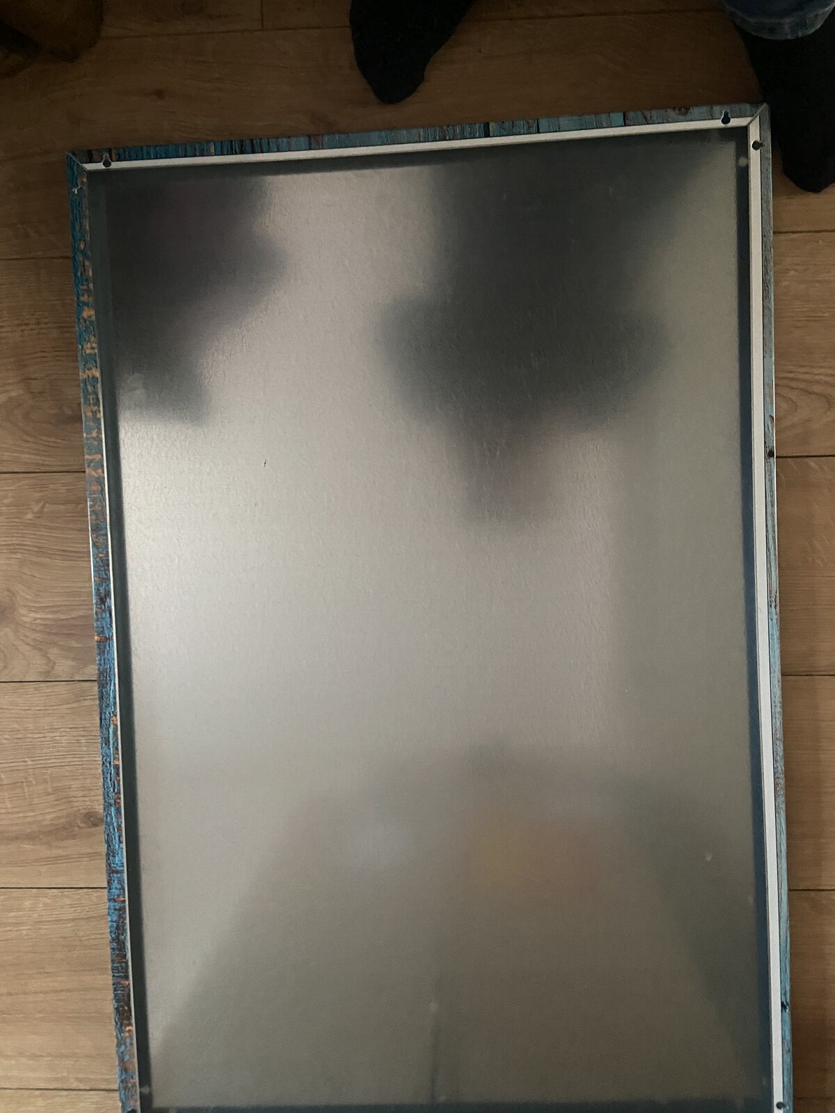

Hi
Never put one of these up before. Positioning the board against the wall with a spirit level and marking corners is easy bit. However, you then have to ensure screw holes in right place and level. (Also taking slight drop in board when fitted to screw)
How would you tackle the job?

Masking tape all the way along. Push pencil through holes.
Now pull masking tape off and stick to wall.
Drill through the holes you have made in the tape.
I use low tack masking like masq purple.
If you have a higher tac masking tape stick it to carpet or a t shirt or something and pull off. The fibers will stick to masking tape and create a much lower tac masking tape that won't pull off or damage paint.
When the screws are in knock with a hammer to fine adjust. Basically bend a bit

I use blu tack; dob on the wall roughly roughly where it needs to be to catch the screw holes, level up and press the pic against the wall leaving an impression of the screw holes in the blu tack, then take the picture away and you can poke through the impression to dent the wall, take away the tack and fit the screws where the dents are
Wetting the blu tack surface will help stop the picture sticking to it but it will only need a light pressure to make an impression

All you need to do is make a small pencil mark at the top and one edge.
Then put a screw in to one of the fittings and measure down from the top of the frame. Take that measurement and measure down from your first pencil line. Now use a spirit level to mark the height at which you will drill.
Left to right- measure from the other (vertical) pencil mark to the centre of the fixing hole, mark it, and then measure the distance to the centre of the next hole.
It really isn't difficult.
As per @Wayners post if you are out by a couple of mm, you can hit the head of the screw slightly (up/down/left/right).
It may take you a while to workout how far to leave the screws projecting out of the wall though.

Fit all 4 screws to the wall somewhere near right. Take a fifth screw and put it into a hole in the painting as it would be in service. Grip it with your fingers as if your fingers were the wall and the. remove the screw from the painting. It is now sticking out of your fingers as much as the others need to stick out of the wall. Wind them til they are thus, offering up the fifth screw to check; when its head is touching the wall, your finger nails/tips will be aligned with the head of the screw that is in the wall. You're essentially using the fifth screw as a simple ruler/depth probe
