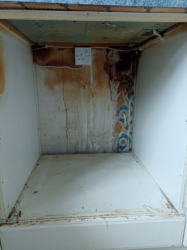

Hi,

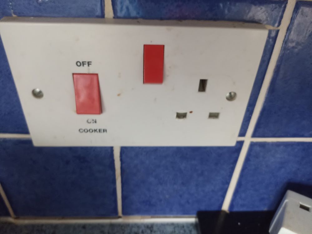

Our (very) old oven packed up a few days ago and we've got a new Bush RLWFOX coming to replace it tomorrow. As there is a cooker switch above the work surface I assumed the oven in there was hardwired. But when I took it out this afternoon there was a plug socket there.
The instructions for the Bush oven say it should be hardwired. But the manual states that Total power(W) is 2215-2635. From what I've read if it's under 3k then it should be fine to put a 13amp plug on the end and plug it into the socket.
Would I be right in thinking that, or am I missing something.
Thanks.

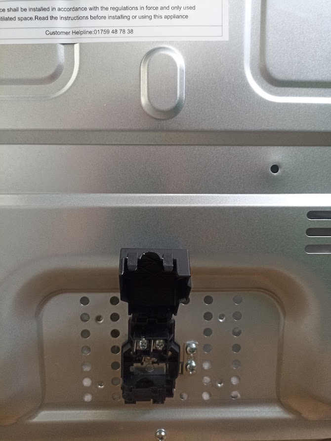

If it comes without a plug and instructions say to hardwire it, I would just do that.
In fact, I've always cut the plug and hardwired any oven I've ever fitted.
You say it is an oven (not a cooker) and draws less than 3kW
So it can use a plug and socket. Which is much easier to plug into than crawling under with a screwdriver.
You ought to find out if the socket being used is part of the general socket circuit, or has been put onto the outlet of a dedicated cooker radial.
A dedicated cooker radial usually has a large switch, like yours, and usually a (large) cooker connector in the wall that an electric cooker (drawing much more power) can be connected into.
It is not wrong to put a socket outlet on, if it is feeding a single oven, or a dual fuel cooker, that draws less than 3kW.

Thanks. The socket in the second picture I posted above leads up to the dedicated cooker switch/socket in my first pic.
Well it seems to be a bit more of an issue than I expected as the new oven has no lead attached to even put a plug onto!
