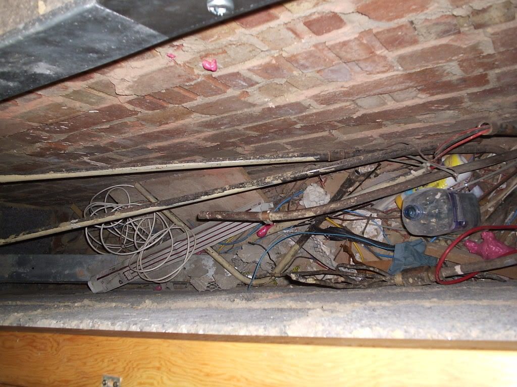

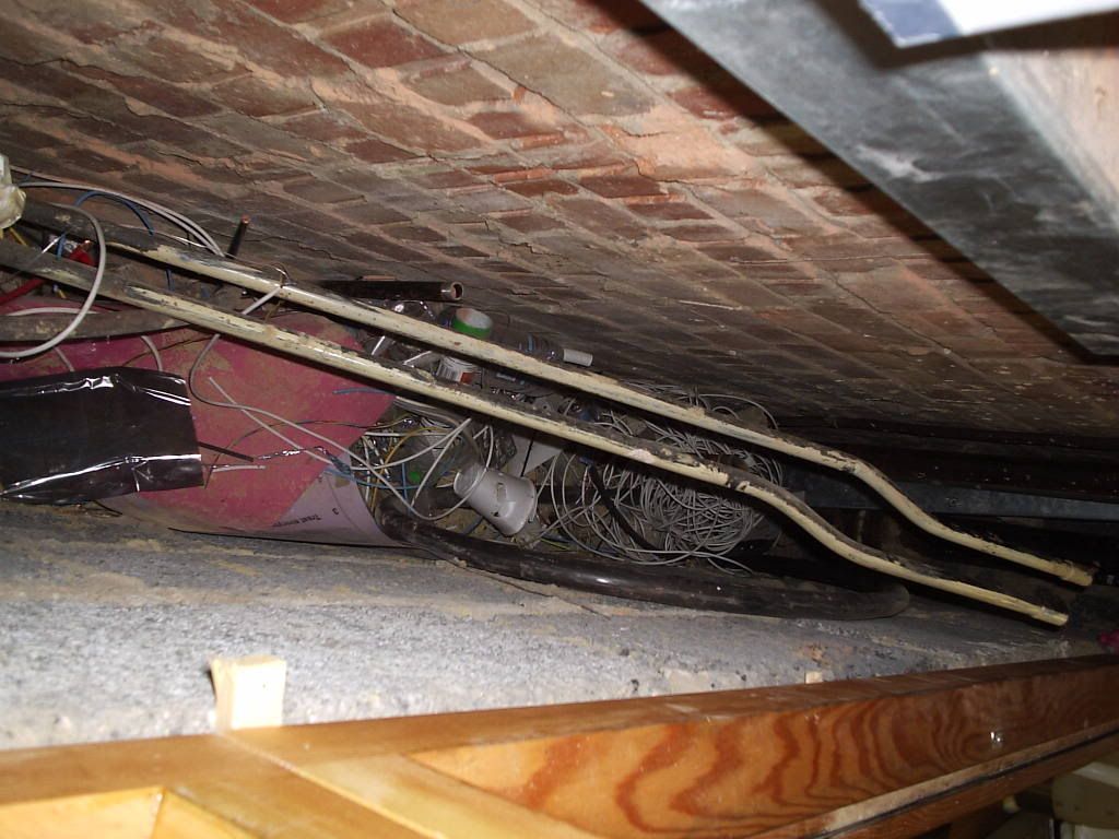

And here are some pictures of the rubbish, that got left behied, in the Ground Floor DB Cupboard:
http://i167.photobucket.com/albums/u125/mdbalson/College H and B Room/P3010042.jpg
http://i167.photobucket.com/albums/u125/mdbalson/College H and B Room/P3010041.jpg

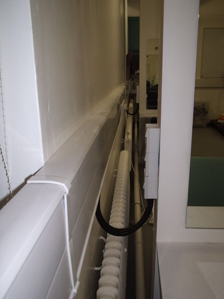

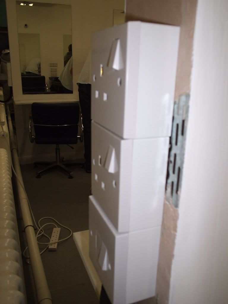

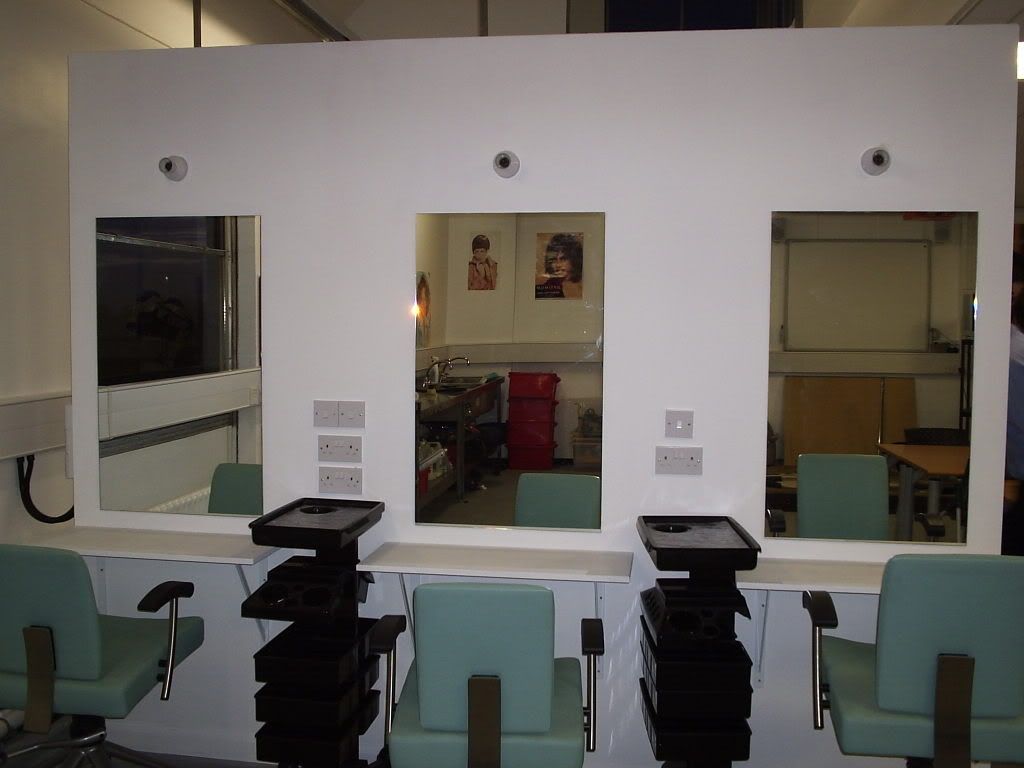

Picture of H&B Bays
http://i167.photobucket.com/albums/u125/mdbalson/College H and B Room/P3010045.jpg
Supply to Bays
http://i167.photobucket.com/albums/u125/mdbalson/College H and B Room/P3010043.jpg
http://i167.photobucket.com/albums/u125/mdbalson/College H and B Room/P3010044.jpg
(The FCU is for the lights, & is spurred off from the origal ring on the left side of the room)
