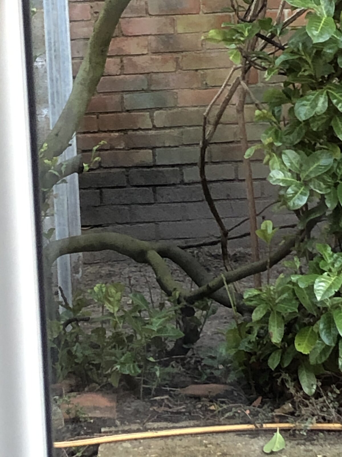

Apologies for the delay but for info this is my neighbours wall, which a year ago was a perfectly lovely straight red brick pointed wall (the breeze blocks is the new extension) I will take photos of the damage to my property too, but I thought if there wall is showing signs of movement (which I have no real idea if this is the case), then this maybe a good indicator of what maybe happening to my property.
