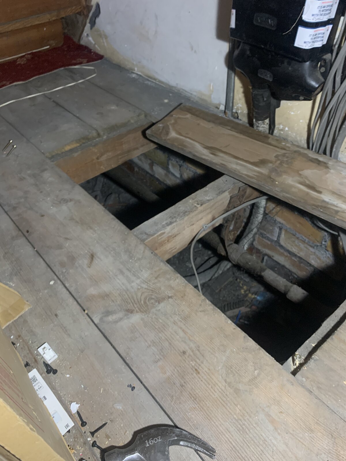

Hi,
just running this by people who know more than me!
I am trying to create access to the subfloor under the stairs.
I managed to get 2 planks off but not enough space to get myself down without crashing into the mains supply cable.
so I want to cut the 3rd plank to the left of these.
I intend to saw through as much as I can with a hand saw and then use a multi oscillating to get through the rest, trying to avoid cutting into the joist.
if anyone has any comments or experience on this let me know as I have a habit of going off half cock and damaging things?
thanks
It doesn't matter if you go into the joist a small amount. Mark the depth of the cut on your multi tool blade and use that as a depth guide.
The alternate option is to cut the board to the side of the joist using the joist as a cut guide for you hand saw and then fix a baton to the each joist to support the shorter cut board.
I'd just cut the board with a multi tool if you have one.
PS why do you need access to the sub floor? I'd stick my head down the hole before you start cutting any more boards and make sure that there isn't a dwarf wall or similar that blocks off you access to wherever under the subfloor you're trying to gain access to.

I have one yes. I can mark on it and I guess if I am a MM or 2 either way it doesn’t matter.
ive already knackered my boiler this week I just wanted to check this now in case I was adding structural collapse to my litany of DIY failures !
as far as I can see it’s a floorboard, not a joist I’m cutting hence makes no different to the integrity of the floor unless I cut in the middle as you say and don’t baton it
cool thanks for your help
Ok so I have made the cuts successfully
The one joist in the middle it’s nailed into, I cannot budge the nails it’s stuck fast.
bolster chisel under then crowbar?
I got a nail punch and the heads are tiny. Punch them in?
Mallet from underneath through the adjacent hole to create a bit of space for a crowbar or get the claw of your claw hammer under the edge of the board and use that for leverage instead.
Ok so I got under but here’s the punchline - it’s blocked off so totally pointless, can only access a small area.
In what way is it blocked? If it's just a rough support wall, you could make an access gap in it, providing you install a lintel to bridge it.

I thought I could make a small hatch near the the edge..so you only need to take up a few laminate planks and not the entire floor to get a plank up? The planks are about 3m long.
I suppose though , IF I need to take it up, I can always just cut a hatch at that point. No need to do it now.
why on earth is this so damn hard. That’s what I want to know.
each room appears to be enclosed by brick on all sides, so I can’t get one access point - you can’t go from room to room under there.
That is unusual construction, they normally have lots of gaps to enable air to flow under the floor, to prevent joint and floor rot, plus of course access below without making lots of access holes in the floor.
