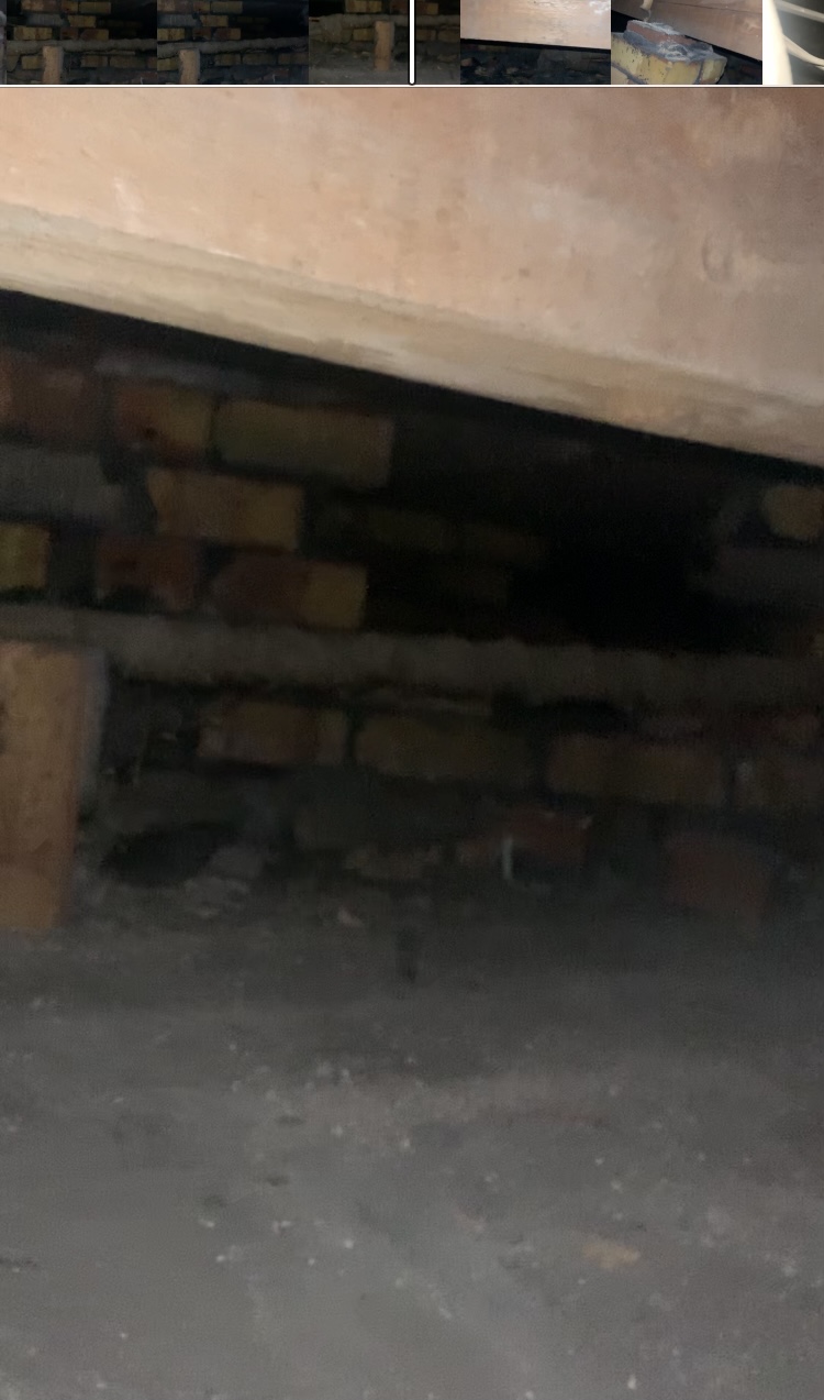

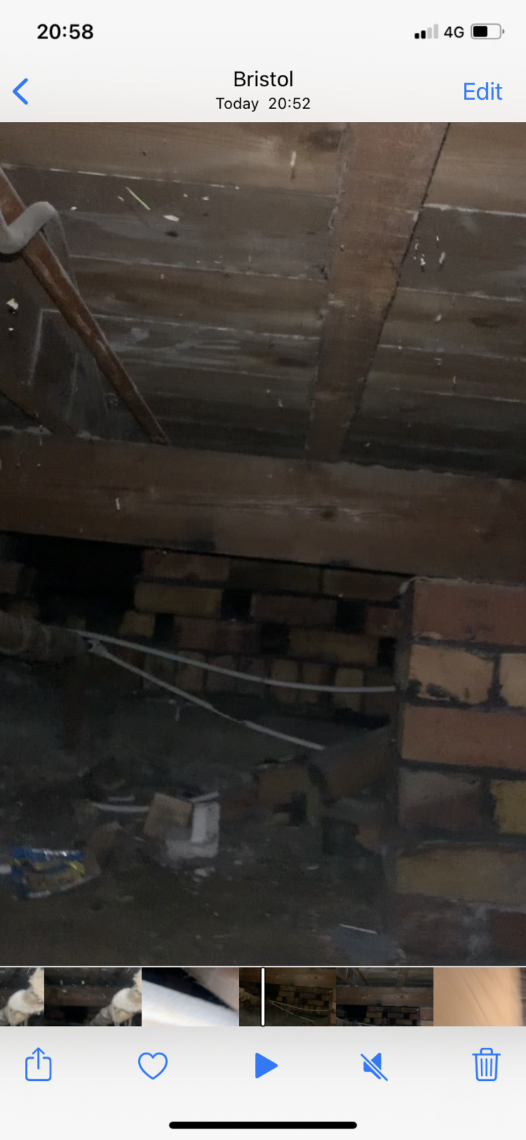

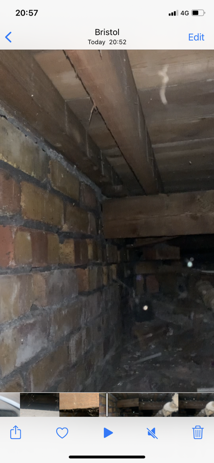

Got some pics
the top ones are under dining room lower ones under the stairs.
plenty of room for air but there is no way I can move about down there!
I don’t know if this is normal, if so, I presume working down here is just for small guys who weigh less than I do!
The ones under the kitchen wall don’t appear to have mortar and are just piled up!
Those gaps I would judge to be fairly normal gaps which I would have got through when I was younger. I would suggest you really ought to make that access hole, on the chance they send a suitably sized person for any under-floor work.
haha, well I am 6 foot 2 and a 34 waist.
I have made the hatch under the stairs. I took one look at the gaps and just assumed I would damage the pipes which are there. I don’t know which ones are old and which ones are “live” and I feel like I’m going to knock those bricks down getting through there!
The alternate option is to cut the board to the side of the joist using the joist as a cut guide for you hand saw and then fix a baton to the each joist to support the shorter cut board.
Thats what Ive always done - works fine, no problems.
