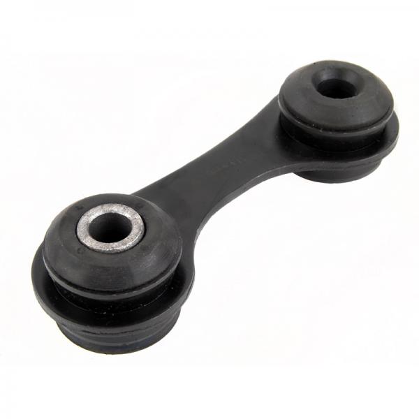

Have any of you ever fitted this type of drop link ? done it now but what a nightmare
19 Apr 2020
535
2
A few months ago I replaced the rear drop links on my vectra C, I thought it was a nightmare of a job , it was so complicated putting them back onto the roll bar.
Am I missing something or are they naturally a pita to replace ?

It depends on the access I guess - the only problems I've come across is that the anti roll bar springs out of the way so either I have a small jack handy or I wedge the roll bar in position before removing the stabilisers. I seem to cut more of these things off more than unbolting them!

Often, it makes a difference where the wheel on the OPPOSITE side is. If you only jack one side of the car up, there will be a twist down the anti-roll bar (that's it's job, of course!) and there will be a fair bit of load on it. The manufacturer will have built the car so that the load on the droplink bushes is least when the car is sat at "mid-laden" on all 4 wheels on level ground.
I often find that when I'm struggling with a droplink, jacking the OTHER side of the car up can help take the load off the bar a bit and make it easier to line things up.
