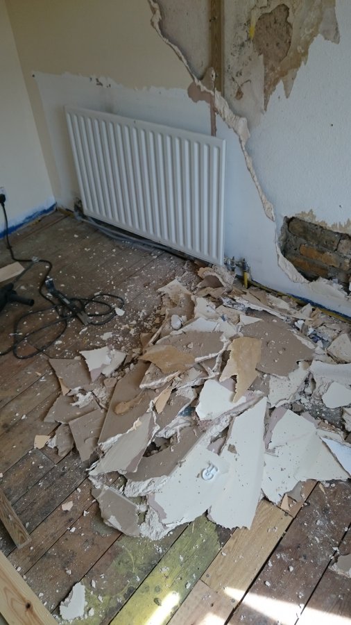

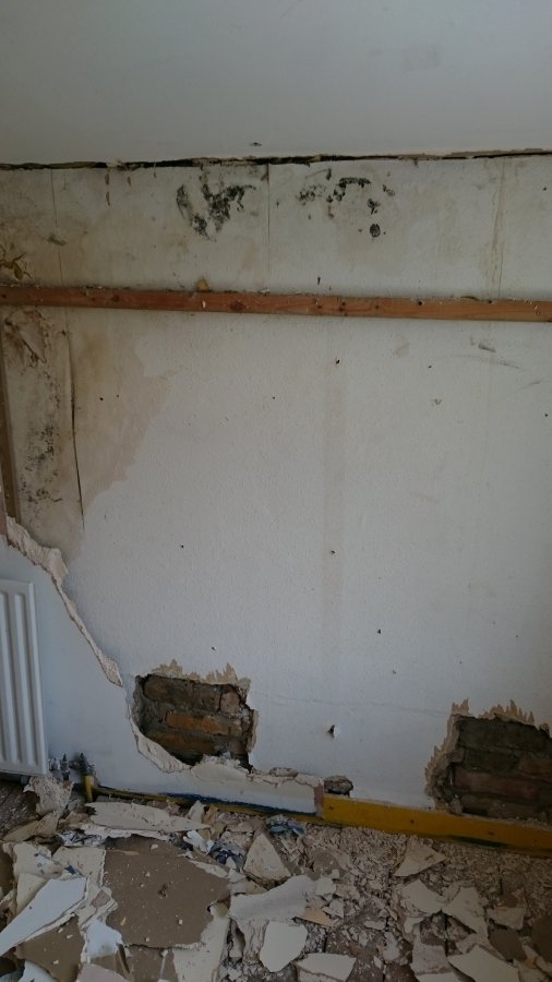

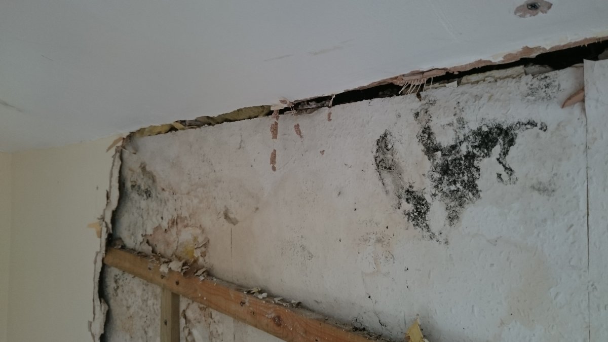

I've started to take down the plaster and plasterboard in what will eventually be our new bathroom. I'm glad I did as structurally some of it is shocking. The batons that go into the brick are loose and it's all a bit of a mess.
The plan (once the electrician has been) is to put new batons up and then drywall.
Regarding the huge gaps at both the top and bottom of the wall. Is this anything to be concerned with? Should I look to cover these gaps with the drywall once it's installed?
I'm concerned I've bitten off a little more than I can chew but I'm determined not to be phased by these holes and crevices (and the spiders) .
I've attached some pictures which hopefully will help.

Its hard to see what I'm looking at but has someone put a battened plaster board "wall" up on top of an existing plaster wall or is that the other side of the wall? If its the former I'd be tempted to carry on to the brick and if its an outside wall consider insulation backed plaster board on dabs. You wont then need any battens. If its the later than I'd be considering propping up the ceiling and rebuilding the entire stud from scratch, giving you a nice place to get all your services in.
I believe it's the former.
Brick > plaster > battens > plasterboard > paint.
It's all coming down. It's actually quite therapeutic.
Any tips for when installing the drywall?
The best tip is dont install drywall in any arrangement.
Go back to bare brick (and any bare studs) all around.
Render the masonry with a 3:1 sand & lime mix. Dont use gypsum plaster.
Use backer board on stud framing.
The ceiling/wall junction can be easily repaired.
The electrician should chase his runs into the brickwork - but most cable in a bathroom is dropping down from the ceiling area.
Remove the rad & any other fixtures to give a clean run at refurbishing.
All pipework to be concealed if possible.
Is there a chimney breast, or where a chimney breast used to be, in your bathroom walls?
Once you get all the boards off and back to brick, from looking at the 2nd and 3rd pictures, have a close look at the brickwork for signs of damp.
There looks like some black mould on the inner layer of plasterboard.
It could be condensation from moisture in the bathroom on cold spots on the inner skin, or as it's high up, some water from above (leaky guttering etc) and just found its way with the large gap. Worth eliminating any risk here.
