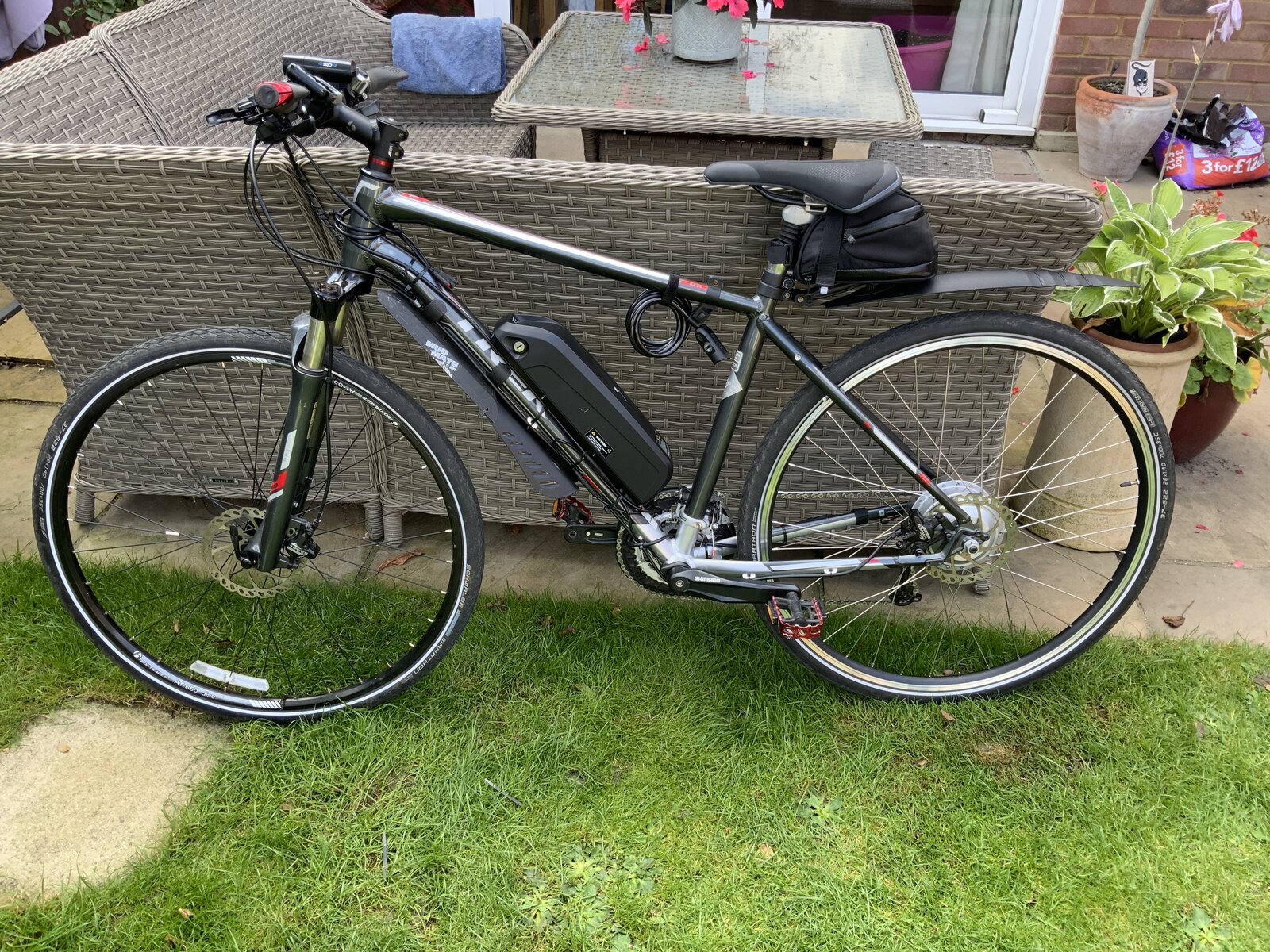

I converted my bike to an e-bike with a kit. 250w motor and it can be set at either 25kph max speed or anywhere up to 40kph.
