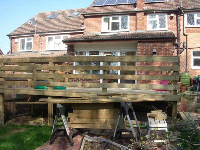

I researched constructing a deck to level our back garden and make it child friendly, this was in 2007.
Our garden is terraced with a 7 foot patio outside the back door, a 2 foot drop, then a patio for a further 8 foot, then slops downwards away from the house.
The deck was constructed last month, sat on top of the higher patio, then straight out over the lower patio, raised up, to the front of the lower patio.
Our view of the our neighbours garden has always been clear from the upper patio, whilst we are a semi, the adjoining house is 4 foot lower than ours. Add to that that they lowered their patio whilst having an extension built, a fence (their fence) that stands 7 foot high from their patio is only level with my knees when I am stood on my upper patio. Having built the deck out across the garden, clearly I have extended our vantage point. Even when stood on the lower patio I have a clear view over their fence and though their kitchen window. (Our neighbours to the other side look down onto the deck).
I hadn't realised the regulation change and had thought I had explained fully our intentions to our neighbour, but they weren't happy. I thought I was within my rights and we talked about having adult conversations should there be problems in the future where we could discuss screening or whatever might need to happen should the neighbour feel there were real problems.
However, I was unaware that a raised deck now requires planning, and after a visit from the council, I am now expecting a letter to apply for retrospective planning. (Didn't get an answer immediately, the officer had to check with the office their interpretation of the rules).
So, I can apply for planning, which should only cost £150, however I am sure getting drawings done is going to cost me more. Add to that that we will likely get refused, and whilst the officer told me we could appeal, that is going to add costs, money I don't have. The truth is we are going to have to make alterations to get it passed or put up higher screening (we don't want to obstruct other neighbours views up the hill with higher screening).
So, the question is, now that we are on the council radar, if I were to chop the deck at the front of the original higher level patio and lower the front 8 foot down onto the lower patio, resulting in a two level deck (with steps), neither of which are going to be more than 30 cm from the floor, will the council accept that, or am I going to have to apply for planning regardless. Whilst this is not as good a solution for us as a family, it is a change we are willing to make to keep the council happy and our neighbours happy.

The ground level used to determine the height of the decking is immediately beneath it. If your decking is less than30cm above existing ground level then it doesn't need permission.
The deck sits 150mm above the ground at the back of the house, but is 900mm above the ground as it extends into the garden. :(
the 300mm is above the natural ground level it covers if its a sloping site it will be higher down hill
but you must take into account different steps or levels at per applicable date
But that is the problem with it all. House is 50 years old, not sure where you find plans with that level of information on it. Could mean that the deck by the back door is actually over the 300mm but where it is currently 2 foot above ground level it could be less than 300mm above the original ground level.

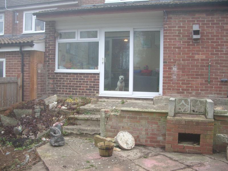

This is what it was like when I started work, the only difference in 2007 when we moved in was plants growing!! So it is effectively the same now as it was 5 years ago.
Counting the brickworks, looks like it's approximately 700mm ish above ground level unless I'm seeing it wrong?
However, it would be a lot easier, less grief and money to lower it, wouldn't be too difficult to lower it providing you know what you're doing by cutting it in the correct order and with temporary supports then any new neighbours won't complain in the future and planning dept will leave you alone but will need a decking stairs to patio door
It's approx 7 foot from the patio door to the front of the brick work, so the deck would need to be split, 7 foot deck in front of the patio, still at that height, then drop the next 8 foot down around 21 inches onto the lower patio, with some steps from the top to the lower level, and a hand rail along the front of the top level. All not too bad to do, but as the top deck will still be there, albeit a lot smaller, and there is no way to lower that, I need to confirm that this will be enough to placate the council and keep everyone happy.
